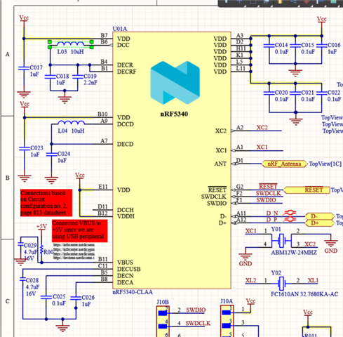

I have been trying to figure out if D+ and D- can be directly connected through a USB connector to 5V. I guess I am still not confident. Would you please comment on if my circuit below is correct?
Thanks.

It's recommended to add ESD protection to the USB lines. Else, you can connect them directly.
