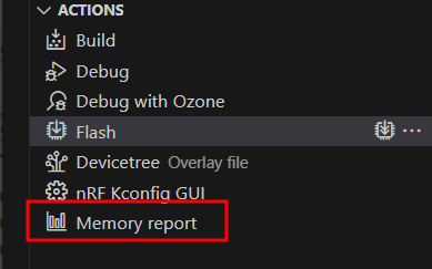

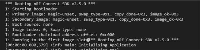

    I flashed the project:
    And the micro rebooted and called the application. I was not able to see these messages:
    I'm guessing that the bootloader is there but I don't know yet. I will try to get onto jLink and start a debugging session. I was not able to set MCUBoot to print.

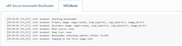

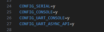

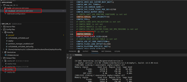

    Please check if CONFIG_SERIAL is enabled in your mcuboot build:
    Albert_0 said:
    My question now is... where do I find information on how to trigger MCUBoot to stay in bootloader mode? Do I need to erase the "rsp" structure perhaps, set a variable somewhere? Ah, yes, I forgot to mention, I have no physical access to the PCB in form of buttons or other.
    FW updates are received and stored in the secondary slot by the application, not the bootloader.  The bootloader is only responsible for validating and activating the update on next reboot. It is possible to perform a FW update within the bootloader, but this is limited to serial DFU. The bootloader cannot receive an OTA update.

    I have
    in my main application. Do you mean I need to add that into the "prj.conf" file in the mcuboot's directory? The one from "C:/ncs/v2.5.0/nrf/modules/mcuboot" (my installation path)?
