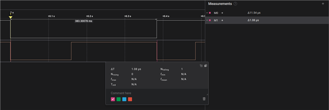

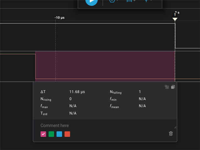

    I am measuring 11.7 us when using direct IRQs and zero latency interrupts, ie. a bare metal implementation of GPIOTE:
    Topmost is the gpio output (LED), bottom most is the gpiote in (button in my case).
    What I tried is to run everything from RAM, but this will only help for the subsequent interrupt if the cache hits successfully:
    If there's another thread that has been active in between, you will still see ~12 us delay from wakeup. The main contributor here is the internal regulator settling time from sleep -> active state.
    If another thread is currently active, you will then see much lower latency, as you also mention; as the system is currently not in a low power state.
