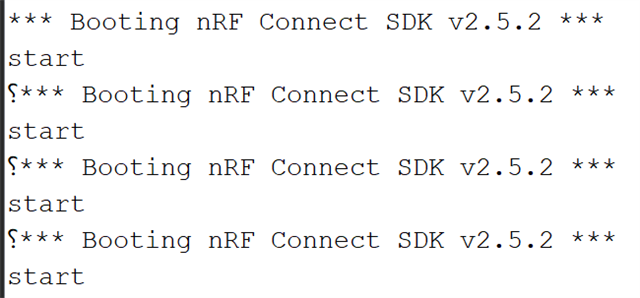

I am trying to copy the function to RAM and then call it using a function pointer like below:
It forced a system restart and it should have encountered an error.
Can you please help me deal with it? Thanks in advance!

    Unfortunately it met the same reboot issue after I flashed it on the nRF52840 DK (code attached)
    Can you please tell me which device you have tested and flashed it on?

    Same reboot for the code below:

    Did I miss something?

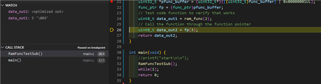

  • Thanks!
    Please check my debugging at your code, it didn't return the data_out2 value, seems that the program didn't execute the "uint8_t data_out2 = fp(3);"
    That's weird, do you think it results from the different device we used?
  • I just tested same code on a nRF52840 Feather, doesn't work with optimisation set to High but works fine with optimisation none. Your capture shows too much optimisation :-)
