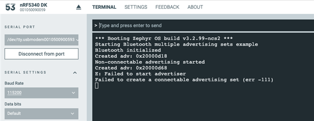

I am using nrF5340DK board. I want to advertise two connectable peripherals from one board. Using the sample application of Multi-advert, I able to advertise one peripheral as connectable and other as non-connectable. When I run this code, I can see both advertise on the client side (nrf connect app). When I modify the code to advertise both as non-connectable, I can see both non-connectable peripherals advertise on the client side (nrf connect app). But when I modify the code to advertise both as connectable, I can see only first connectable peripherals advertised on the client side (nrf connect app) and other one got failed to advertise.
Kindly can you please advise the required configurations I need in firmware to achieve this.
