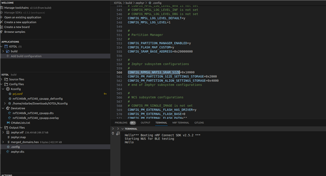

  • Hi Yanpeng,
    By "build result being the same," do you mean that CONFIG_RPMSG_NRF53_SRAM_SIZE is still set to 0x0 in your .config output?
    Vidar
  • Hi Vidar,
    Sorry for the mistake. When I did a Pristine Build, the rpmsg_nrf53_sram was created properly in partitions.yml.
    But when I flash the image to DK, still can see 'ble_host: Failed to send data over BLE connection', sending data from appCore terminal failed. (the data flow from mobile app to appCore terminal is ok)
