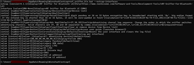

4) A picture of the output after the execution of:
nrf_sniffer_ble.bat --extcap-interfaces
It seems everything is working as expected!
5) Regrettably, when I launch Wireshark, the nRF Sniffer is not included in the Capture list.

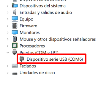

    As my Sniffer is not listed in the Wireshark interface, I've tried the following of the troubleshooting guide. I hope this could help.
    1. The dongle is recognized by the Programmer SW as a nRF Sniffer for Bluetooth

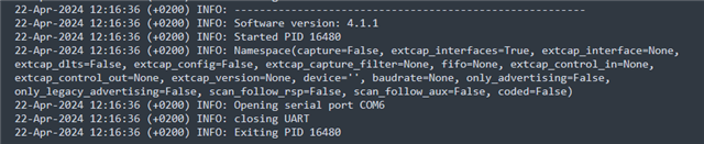

    4. Upon executing nrf_sniffer_ble.bat --extcap-interfaces the following print is shown and then the log.txt file shows:
