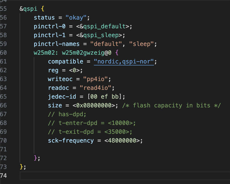

    I have been attempting the following for the qspi device. I am using the sample in zephyr spi-flash for this integration.
    After going through many threads online, i configured as follows:
    Calling the device via compat: nordic_qspi_nor
    disabled - &mx25r64
    Set pin configuration according to my hardware connections.

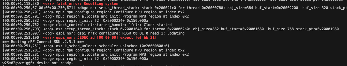

    When built and run, the code gives an error log. Please give any suggestions to help read device and use the sample correctly for my flash chip. Thanks
    error:
    My device tree overlay is set as follows, kindly let me know how to resolve this and start reading writing and flashing into the flash chip.
    Overlay for qspi:

  • Hi
    What pins have you connected the QSPI to on the nRF52840 side? This JEDEC id error is usually seen either when using GPIOs that are doing something else or if the SPI isn't set up correctly in the .config and .dts files in your project.  Since one of the recommended QSPI pins are P0.18 (which is also the reset pin) you need to make sure your project builds with the CONFIG_GPIO_AS_PINRESET=n set by default.
    Simon

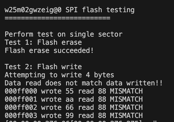

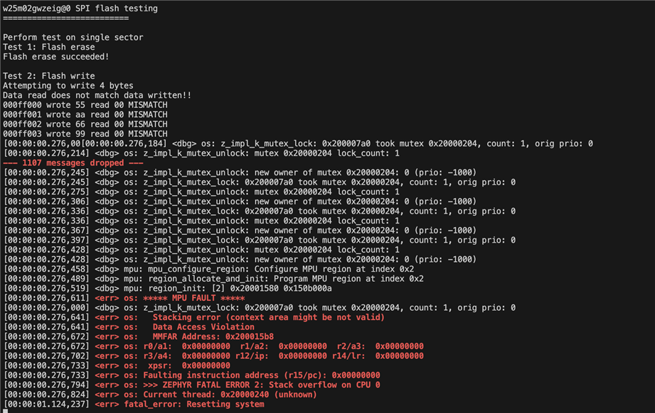

  • Hi, Hello! Thanks much for your previous response. Was able to get the device to recognise.
    But i keep getting the read mismatch as follows:
    Any suggestions to help with this? Thanks much, Simon.

  • Hi
    What address are you reading from here, as it seems like you're always reading the same value I would assume you might be reading a specific address rather than the one you just wrote to. Please show me how you enable reading and how the read function looks in your application.
    Simon
