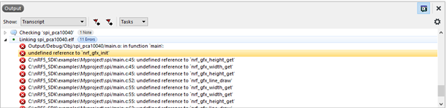

Hello everyone I hope you are well,
I am trying to use e-paper screen with pca10040 devkit however,
I would like to ask a question about how can I fix undefined reference to `nrf_gfx_init' problem
I take the nrf_gfx.h and .c file into a a file which I named it  external libraries but .c file looks pale written
I think something goes wrong while inserting functions.
If anyone can help I would be really grateful.
  • An issue caused by unfortunate obfuscation choices, use of ## and so on; one reason (in my view) why the SDK was abandoned.
    The likely cause of the error is "NRF_GFX_ENABLED" in sdk_config.h being '0', simply change it to '1'.
     Directory of D:\Projects\Nordic\nRF5_SDK_17.1.0_ddde560\examples\ble_central\ble_app_hrs_c\pca10040\ser_s132_hci\config
    sdk_config.h
    // <q> NRF_GFX_ENABLED  - nrf_gfx - GFX module
    #ifndef NRF_GFX_ENABLED
    #define NRF_GFX_ENABLED 0
