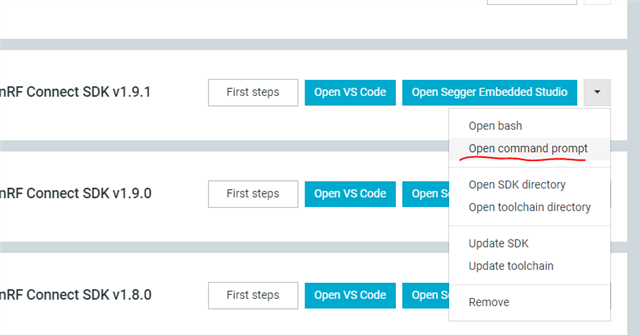

    How did you install the nRF Connect SDK? I see that you are using v1.9.1. Can you please try to uninstall it, and install it via nRF Connect for Desktop -> Toolchain Manager?
    I also don't know where this log is coming from. Did you try to build using a command terminal, or Visual Studio Code?
    When you have installed it using the Toolchain Manager, try pressing the down-arrow, and "open command prompt", and see if you can build from that command window.

  • Ok. It may be that the entire SDK and tools were not installed properly.
    Can you please try to open a terminal from nRF Connect for Desktop -> Toolchain Manager -> Open command prompt:
    And navigate to the ncs\nrf - folder (just type "cd nrf", and it should be in the correct folder). Then type "west update":
    What does it say then? Can you please copy and paste it all here? If it looks successfull, and if it looks like it did some work, can you then please try to build again? (close and open VS Code before attempting).
    If that doesn't work, you can also try to run both "Update SDK" and "Update toolchain" from the Toolchain Manager plugin in nRF Connect for Desktop.
    If nothing works, please try to "Remove" the v1.9.1, and then reinstall it.

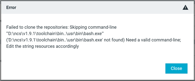

  • Thanks for your detailed guidance!
    When I operated "west update" in the command prompt, error occurred. And the report is as follow:
    D:\ncs\v1.9.1\nrf>west update

    fatal: 'submodule' appears to be a git command, but we were not
    able to execute it. Maybe git-submodule is broken?

    ERROR: update failed for project matter
    And when I tried to update the SDK from the Toolchain Manager, error ocurred either.
    I'm now trying to reinstall it.
