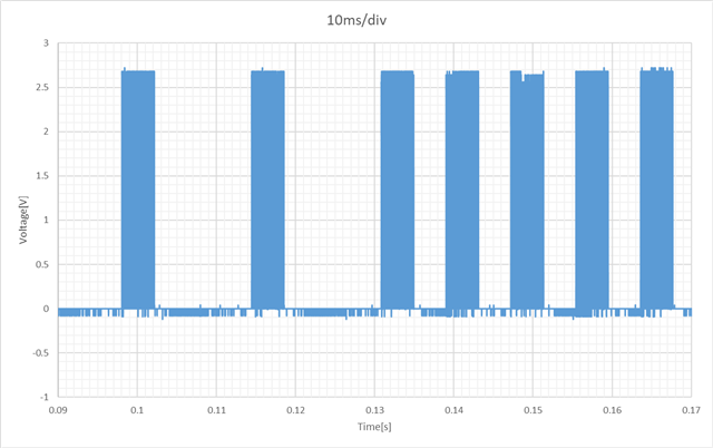

I created a code that switches the PWM duty every 562us or 1.69ms. The implementation uses the pwm_set_dt() function to switch the duty and waits using the k_busy_wait() function until the next pwm_set_dt() function. When I implemented this in an empty application, it worked correctly as intended.
However, Matter applications created from Matter: Template are exhibiting strange behavior. Specifically, the PWM output is controlled according to the ClusterId and AttributeId received by the MatterPostAttributeCallback() function, but the wait time in the k_busy_wait() function during PWM control is extended.

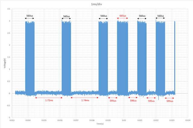

When I checked the PWM waveform with an oscilloscope, it was as shown in the graph. The correct time is 562us for the short wait and 1.69ms for the long wait, but as shown in red, there is a wait that extends for several tens of microseconds. There is no regularity to this extended wait time, and it appears to occur randomly.
Why does this phenomenon occur?

    When you are using k_busy_wait, other higher priority threads or interrupts, like radio activity in Matter samples will be allowed to run and preemt the thread where you are busy-waiting. It is normally not possible to get exact timing in the application when you are running radio protocols together with other tasks, since there is only one CPU that must be shared between all tasks.
    You can try to increase the priority of the thread that does the PWM duty cycle updates, but most likely, radio protocols will have even higher priority.
    I would also recommend you to not use k_busy_wait, as this is not optimal when it comes to power consumption and application flow. k_busy_wait will block other lower priority tasks from executing, and it will keep the CPU on and busy, burning power for no reason. You should rather use k_sleep to put the thread to sleep for the desired time, or use a timer to change the PWM duty cycle.
