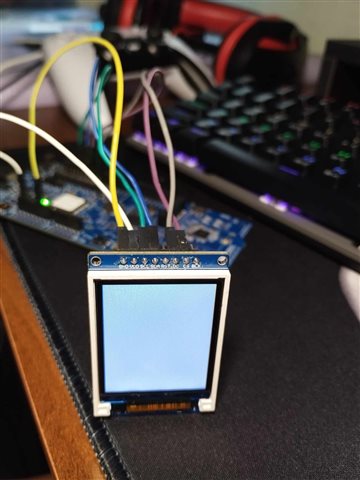

Hi all,
My SDK version:17.1
I want to use the GFX example that is in Example/peripheral with my nrf52840dk to  display some text on ST7735S LCD screen(128*160).
The code had been downloaded into the 52840dk but the LCD just had a white screen at all,nothing change.
The example code is as default,I just make one change:
static const nrf_lcd_t * p_lcd = &nrf_lcd_st7735;
And the pin:                    NRF52840DK           LCD pin
ST7735_SCK_PIN 47 --> P1.15                ------SCL
ST7735_MOSI_PIN 45 --> P1.13              -----SDA
ST7735_SS_PIN 44 --> P1.12                 ---------CS
ST7735_DC_PIN 42 --> P1.10                ---------DC
I don't think that the problem is on Lcd beacuse it works with  Arduino.I have read others topic about this problem but none of these work for me.Thanks!

  • Thanks you for spending time with my problem,
    I had changed the frequency as the code you showed ,but nothing happed,my LCD screen just had white screen on it.
    But i see the LOG message on the Realterm:
    I don't know where the problem is?
  • ok. I can't tell from your picture, but you have VDD connected to your VDD pin on the DK, and not 5V, right? And GND is connected to GND? Also, can you please show me how/where you set the pin numbers that you are using?

    You said that it was working fine with the arduino. When you tested this, did you connect the reset pin? It says that the reset pin is active low, meaning if you pull it to gnd, it should reset the device, and it needs to be held high during operation.
    Can you try to add this to operate the RST pin as well?

  • Oh it finally works!!
    After i connect the RESET PIN it works(then unplugged it and get white screen),then i try to reset 52840dk for serveral times and have these three conditions:
    -Log message stop at "Starting main loop" and white screen
    -Sometime the log message print "1,2,3,4" but the LCD is white screen
    -LCD works normally
    I think it maybe the connection is not stable that cause the problem,and the RESET PIN is really important.
    Thank you for your help!!
