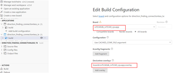

hardware: nrf5340-dk
ncs:2.5.0
sample: direction_finding_connectionless_rx  &  direction_finding_connectionless_tx (AoD mode)

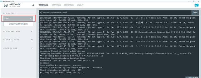

Creating Periodic Advertising Sync...ASSERTION FAIL [err == 0] @ WEST_TOPDIR/zephyr/subsys/bluetooth/host/hci_core.c:338
*** Booting nRF Connect SDK v2.5.0 ***with err -11
after debug, I find the code stall at hci_core.c 388:
err = k_sem_take(&sync_sem, HCI_CMD_TIMEOUT);
BT_ASSERT_MSG(err == 0, "command opcode 0x%04x timeout with err %d", opcode, err);
I cannot run into create_sync() after the scan_enable() is runed even if I run the Rx sample along with the TX sample.

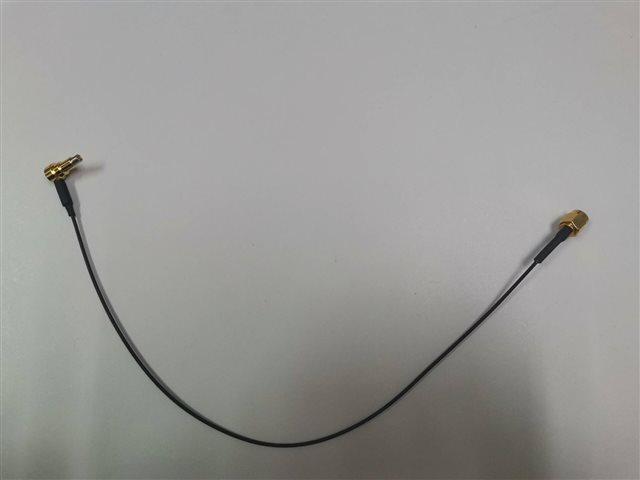

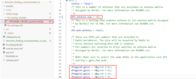

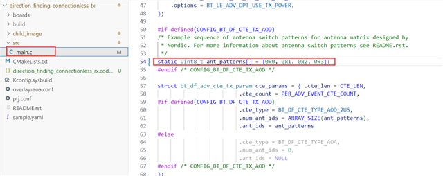

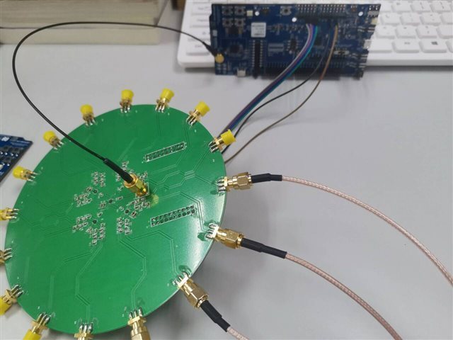

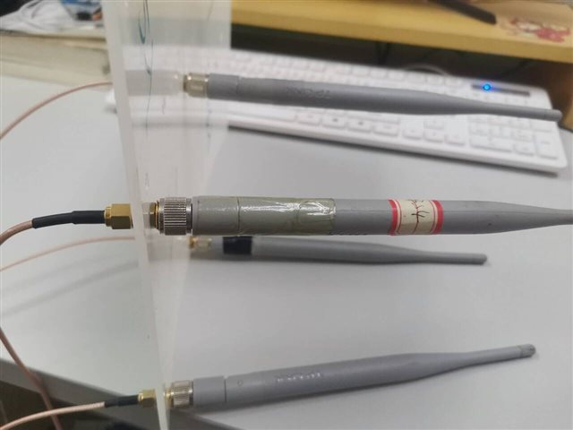

I connected an external antenna matrix with 4 antennas at the TX end using an RF connector, I tried the connection example (Direction finding central/peripheral)  and used the same configuration as direction_finding_connectionless_rx/tx,and according to Direction finding central/peripheral testing, the antenna signal was indeed successfully connected to the external antenna.It did connect successfully and received CTE data.But in direction_finding_connectionless_rx/tx example, using the same configuration failed.
direction_finding_connectionless_tx(AOD mode):

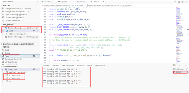

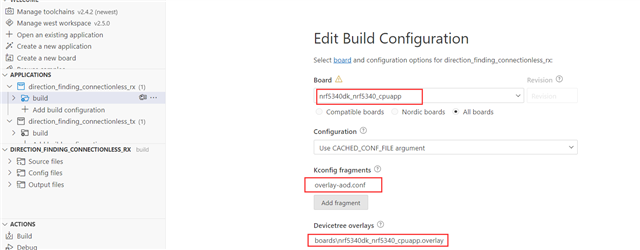

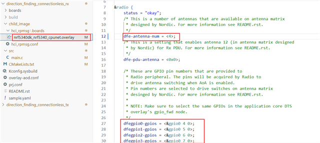

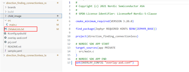

direction_finding_connectionless_rx:

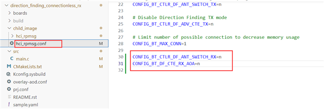

Configuration:
Control panel output:
First time programming code:

Continuous second time programming code:
[DEVICE]: 7B:34:B4:83:65:85 (random), AD evt type 3, Tx Pwr: 127, RSSI -68  C:0 S:0 D:0 SR:0 E:0 Prim: LE 1M, Secn: No packets, Interval: 0x0000 (0 ms), SID: 255
[DEVICE]: 76:E6:BA:B0:C6:17 (random), AD evt type 3, Tx Pwr: 127, RSSI -64  C:0 S:0 D:0 SR:0 E:0 Prim: LE 1M, Secn: No packets, Interval: 0x0000 (0 ms), SID: 255
success. Found periodic advertising.
Starting Connectionless Locator Demo
Bluetooth initialization...failed (err -11)
success
Scan callbacks register...success.
Periodic Advertising callbacks register...success.
Start scanning...failed (err -11)
Waiting for periodic advertising...

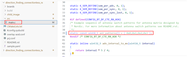

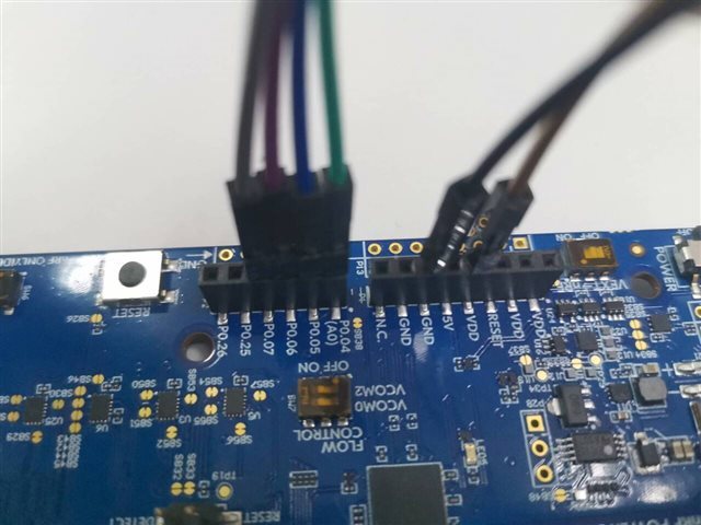

Antenna matrix connection(TX  AOD):
Four GPIOs used to control antenna switching are connected to the external antenna matrix via DuPont cables.The antenna array is connected through RF connectors.
  antenna
  RF connector
I don't know if it's a problem with my hardware configuration or software configuration.
    Could you provide more information on what is shown in "first time programming code" and "continuous second time programming code"?
    When exactly did the ASSERTION FAIL error occur? Is assertion error reproducible on your end?
    Dejan
  •  Hi,Dejan
    Thank you very much for your comfort. I have tried to adjust my mindset and I believe that the problem will eventually be solved.
    After the sender's code was flashed to nrf5340dk, I flash the receiver's code on another board. On the receiving end, after the first time flash the code, I clicked on flash key again, and the results of these two burns were different.The console has been printing text like this:"[DEVICE]: CF:62:C2:8A:64:34 (random), AD evt type 3, Tx Pwr: 127, RSSI -72  C:0 S:0 D:0 SR:0 E:0 Prim: LE 1M, Secn: No packets, Interval: 0x0000 (0 ms), SID: 255", but there is no synchronization.

    2.continuous second time programming code:
    Most of the time it's like this:
    [DEVICE]: 26:30:76:21:1B:4E (random), AD evt type 3, Tx Pwr: 127, RSSI -87  C:0 S:0 D:0 SR:0 E:0 Prim: LE 1M, Secn: No packets, Interval: 0x0000 (0 ms), SID: 255
    success
    Start scannin*** Booting nRF Connect SDK v2.5.0 ***

    Sometimes it's like this:
    success. Periodic sync established.
    Enable receiving of CTE...
    Bluetooth initialization...success
    Start scanning...success

    Even in rare cases, CTE can be received, but the device's address is not the address of my another board, which means CTE has not been received yet:
    PER_ADV_SYNC[0]: [DEVICE]: 3D:B6:BC:D3:8F:23 (random) synced, Interval 0x0780 (2400 ms), PHY LE 2M
    success. CTE receive enabled.
    Scan disable...Success.
    Waiting for periodic sync lost...
    CTE[0]: samples count 45, cte type AOD 2 [us], slot durations: 2 [us], packet status CRC OK, RSSI -450
    CTE[0]: samples count 45, cte type AOD 2 [us], slot durations: 2 [us], packet status CRC OK, RSSI -410

    I don't know how to get UART log from the network core.What I have obtained is the printed output of the terminal, which should be the output of the application core.I am looking for how to get UART log from the network core.
    You can just use another VCOM port to which you connect using your terminal emulation application.
    Dejan
    I just use another VCOM port to get UART log from the network core.I use COM7 to print the log data of the application core and COM8 to print the log information of the network core. But the printed log data in COM8 does not contain any useful information.
    I flash the code once and it prints it once(*** Booting nRF Connect SDK v2.5.0 ***)
    COM8:
    COM7:
    Could you try to add 2 lines shown below to your child_image\hci_rpmsg.conf file and provide new logs from both cores?
    CONFIG_BT_CTLR_SCAN_DATA_LEN_MAX=191
    CONFIG_LOG=y
    Dejan

    Thank you for your suggestion!I conducted a test, and here are the results.

    continuous second time programming log:
    [DEVICE]: 42:98:50:20:9C:61 (random), AD evt type 0, Tx Pwr: 127, RSSI -58 Apple Pencil C:1 S:1 D:0 SR:0 E:0 Prim: LE 1M, Secn: No packets, Interval: 0x0000 (0 ms), SID: 255
    [DEVICE]: 42:98:50:20:9C:61 (random), AD evt type 4, Tx Pwr: 127, RSSI -58  C:1 S:1 D:0 SR:1 E:0 Prim: LE 1M, Secn: No packets, Interval: 0x0000 (0 ms), SID: 255
    success
