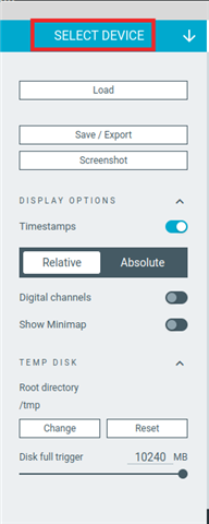

Hi, all.
I'm using PPK2 in amper meter mode.
Version of SW:
- nrf connect for desktop application: v.4.4.1;
- power profiler: v.4.0.0;
- laptop under Linux Mint 20.2
Settings:
- sampling parameters: 100 samples per second;
- sample for 24 h;
- all the rest settings are by default.
The issue is that after ~3 h of work PPK2 stops logging and disconnect the target.
NOTE: while logging in amper meter mode PPK2 constantly lights with Blue LED, once it stops (~3h) it starts blinking with Green LED.
Also, desktop appl looks as follows:
