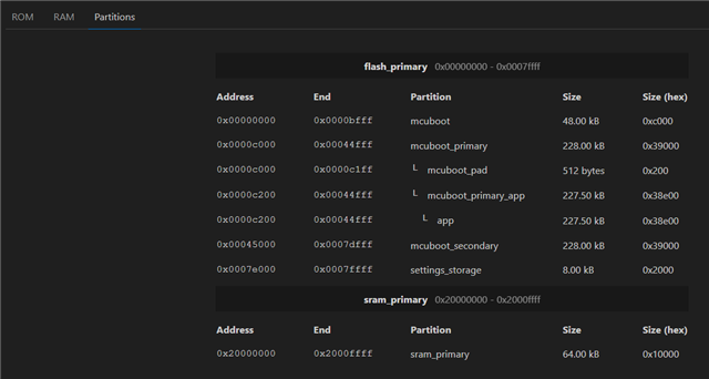

I'm currently trying to add MCUBoot in my project.
The project was built successfully by adding these lines to prj.conf.

After generated the private key, what need to do for using private key is adding this line in CMakeLists.txt
set(mcuboot_CONFIG_BOOT_SIGNATURE_KEY_FILE \"${CMAKE_CURRENT_SOURCE_DIR}/priv.pem\")
And put priv.pem file in project folder(out from build folder)
