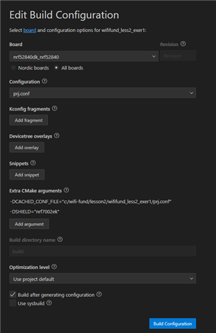

  • Hi, thank you for your response,
    yes indeed i'm using a nrf7002ek with my nrf52840DK, attached are the build/config files and parameters i used.
    I also tried to build it adding the nrf7002.overlay and still got the same results.
    Kind regard,

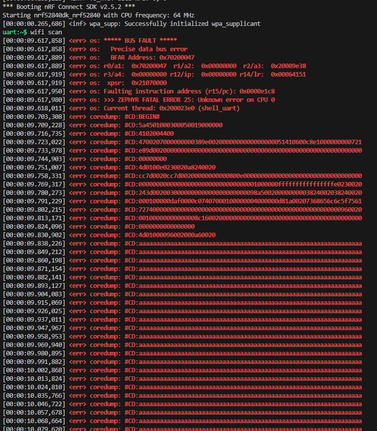

  • also when the "wifi scan" command finally executes this is the result i get
  • Thanks for the configuration files.
    I tried your prj.conf in the "wififund_less2_exer1_solution" sample, and it ran as expected on my nRF52840-DK + nRF7002EK:

    Tested it with both ncs v2.5.2 and ncs v2.6.0.
    Could you try the solution sample and see if this runs as expected on your side?
    Håkon
  • Hello again, i still have the same problem, perhaps it's a hardware issue
