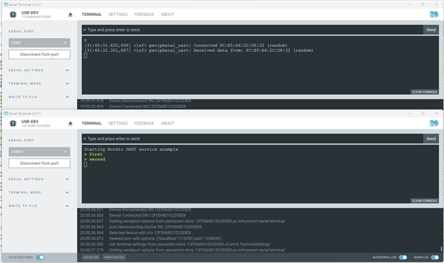

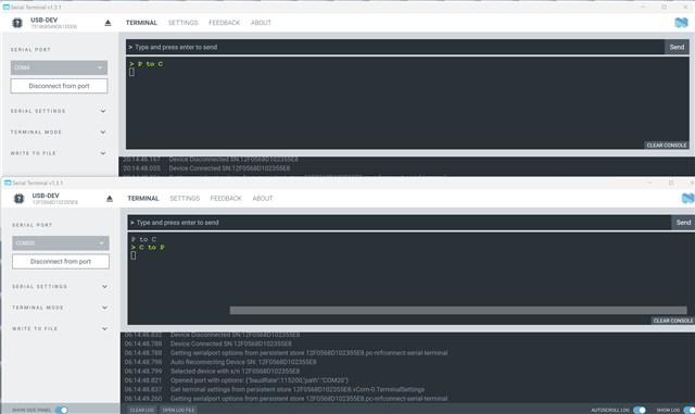

We have Multi-NUS running with USB CDC Support upgraded to SDK v2.5.0, but I only have Rx working when connected to another dev board running the Peripheral UART Sample.  I'm not sure why Tx (sending from Multi-NUS central to the Peripheral) isn't working.  Attached (link below) is my project.  Please let me know your thoughts.

    I only see the "Received: x bytes" and "Broadcasting to 4 peers" print the first time I send something to be transmitted over the Central's USB CDC port.  These prints are not printed out the second time I send text to be transmitted to the Peripheral.  See prints and screenshot below.

    So, I suspect the issue lies somewhere in the broadcasting section of the multi_nus_send() function, but it's not jumping out at me. Slight smile
