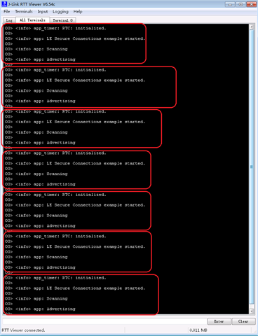

Is the peer functionality related to RTC?
Hello Nordic Engineer,

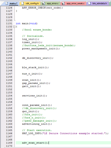

I used nRF52811
nRF5_SDK_17.1.0_ddde560 \ examples \ ble_central_and_peripheral \ experimental \ ble_app_multirole_lesc
After attempting to add NUS, NUS_C, and deleting PEER, and porting to 52811, I encountered an RTC error when running the final RTT.

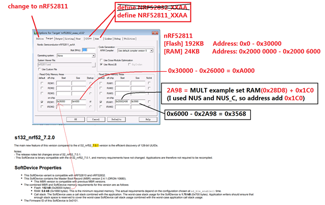

The following image shows the modifications I made for porting to 52811
<sdk_config.h>
UART_LEGACY_SUPPORT     0
NRF_BLE_LESC_ENABLED    0
NRF_BLE_LESC_GENERATE_NEW_KEYS  0
NRF_CRYPTO_RNG_STATIC_MEMORY_BUFFERS_ENABLED    0
NRF_CRYPTO_RNG_AUTO_INIT_ENABLED    0
PM_LESC_ENABLED 0

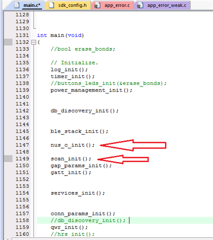

<main.c>
delete --->  err_code = nrf_ble_lesc_request_handler()
Since I don't require the LESC functionality, I hope to have the same connection method as the peripheral UART example.
This is probably all the changes I made. How should I solve the RTC issue?

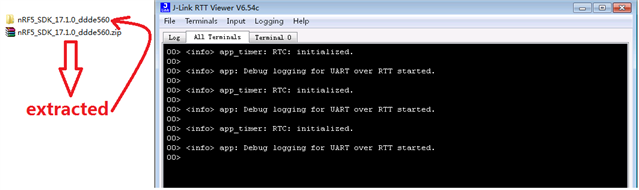

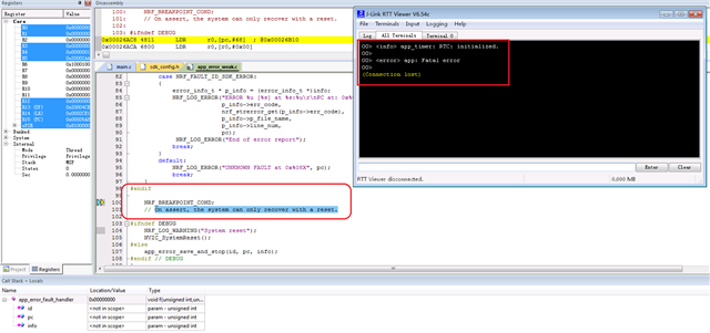

  • I made a significant discovery. After I extracted SDK 17.1.0 and placed it in a new folder, I believe the examples inside have been thoroughly tested by the official team. However, when I found the peripheral/uart example, compiled it, and downloaded it to the chip, I noticed that the RTT still had the issue of repetitive printing. Should we consider focusing on the hardware or perhaps the debugger?

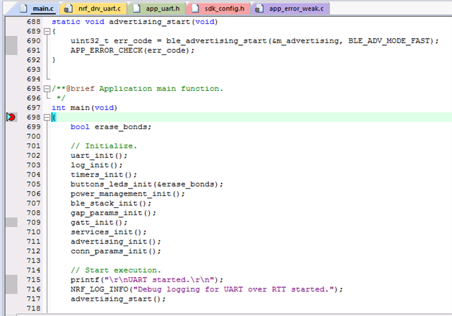

  • I haven't experienced this issue here. I have a board with the nRF52811 and have tested it using the ble_app_uart pca10056e configuration. Please place a breakpoint at the beginning of main() and see if it is reached again after you start execution. This will help us determine whether the device is rebooting.
  • The current breakpoint in this main() function has only been reached once.

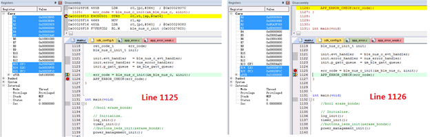

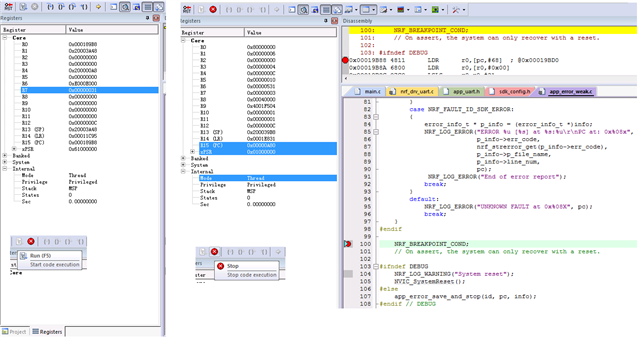

    Something very strange is happening. When I start debugging, I execute 'run', then I click 'stop', but the code window doesn't display the current position where it stopped. Then, I repeatedly click 'run' and 'stop', and only register R7 is changing in the left register window. Eventually, it ends up in NRF_BREAKPOINT_COND error.
    I just discovered an issue: after starting debugging, it keeps running continuously without me clicking 'stop'. After about 10 to 15 minutes, it also ends up in NRF_BREAKPOINT_COND.
    Additional note: During the 'run' period, my phone can scan and receive broadcast information from the device.
  • The Softdevice will raise an assert if you start and stop exection as it will break it's real time requirements. So, this is to be expected. The ble_app_uart will also attempt to enter System OFF mode (deep sleep) when the advertiser times out after 3 minutes. But it is not possible to enter System OFF when the chip is in debug interface mode, so this will also trigger an error.

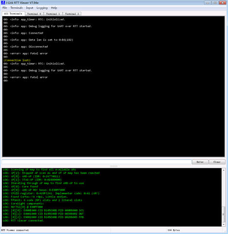

    I see you are using an old Jlink version. Could you try to update your nRF command line tools package (https://www.nordicsemi.com/Products/Development-tools/nRF-Command-Line-Tools/Download) and see if that changes anything?
  • I installed the new nRF command line tools, and it also asked me if I wanted to install J-Link 7.94e, to which I agreed.

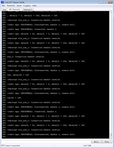

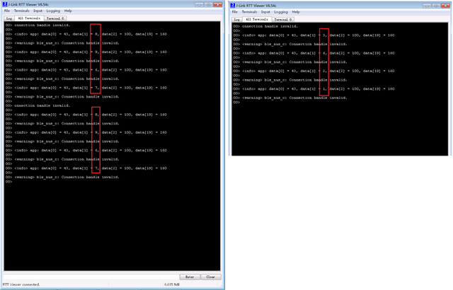

    The test results are divided into two sections, with the yellow text 'connection lost' in the middle. Above that is when 52811 is running. I connected and then disconnected with my phone, then after a short period of time, an 'app: Fatal error' occurred.
    Below the yellow text is when 52811 is running. I didn't do anything, and after a short period of time, an 'app: Fatal error' also occurred.
