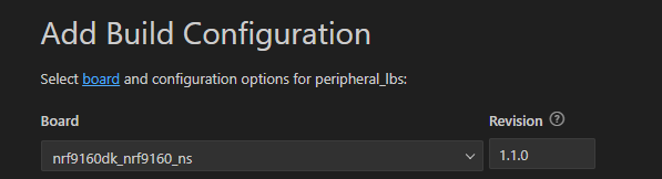

    I build it for nrf9160dk_nrf9160_ns as I will be using it for nRF9160 dk board.
  • Try adding the revision of the DK you have in the Revision field. example:
    Adding the revision filed gives different error but it is also related to device tree:
