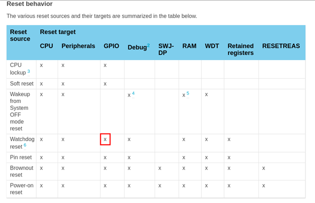

As soon as the device resets I am experiencing the GPIO pin changing it's status, I thought that maybe the WDT resets the entire SOC (GPIO peripheral included).

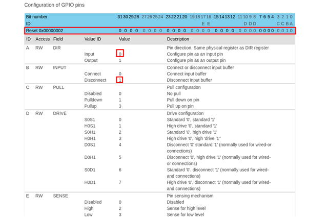

    It is not possible to retain the GPIO configurations through a WD reset. The reset will reconfigure all pins to their default state.
    Reset behavior
    Default reset state:
    PIN_CNF[n]
    I may be able to suggest another approach if you could provide a bit more information about the use case and what you are trying to achieve.
    Vidar

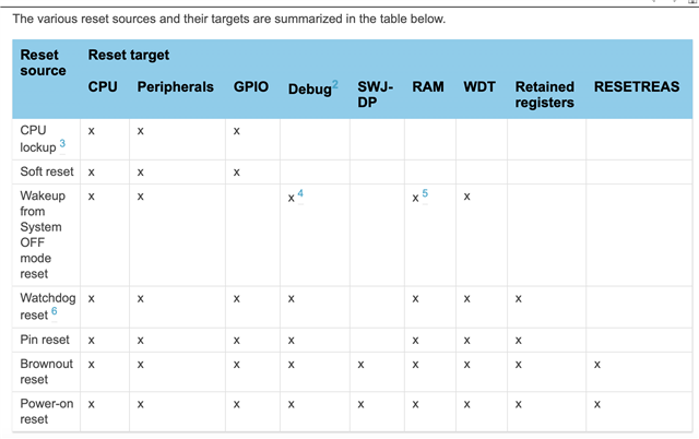

  • I wanted to retain the GPIO output status after a reset occurs so that after reset it will recover it's status, and I thought a solution "confined" to the GPIO peripheral without involving any non-volatile memory. But at this point I don't know if it is possible
  • Yes, that will require use of NV memory, or GPREGRET.
  • ok for NV memory, but for GPREGRET I am seeing that a WD reset will clear and reset the value, does it?
