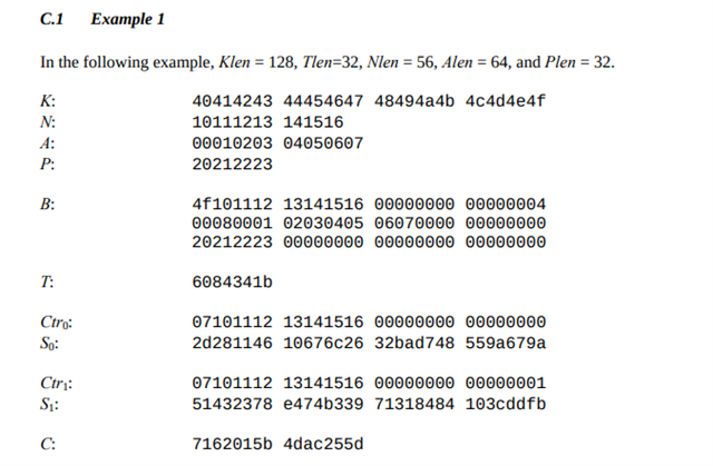

  • I just tried with 128 bit key the output is not same. I tried one example from NIST_800_38C document  example 1. In python library gives the same output but nrf52840 gives different output.
    Clipped From NIST 800-38c
    My constraints is not to match the 128 0r 256 bit. I need to match the nrf52840 and python script output.

  • I'm able to match the output from the c code and the python script when using the original input you posted.
