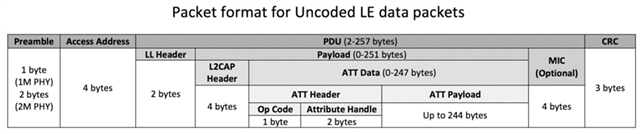

I have a doubt with my firmware implementation.
In my previous implementation i had no security and I was sending packets which were 244 bytes long.
Now i have implemented security through peer manager (bonding Le sc with just works).
According to the following image:
Now i should consider also the Mic field, which is responsible for encryption. How should i consider it? Should I increase the pdu? How? should i decrease the size of my packets from 244 to 240 in order to consider this additional header? Should i decrease/increase the NRF_SDH_BLE_GATT_MAX_MTU_SIZE? It is not clear for me.
Before the implementation of security communication was correctly performed, now is not.
Thanks in advance to anyone who can help me
