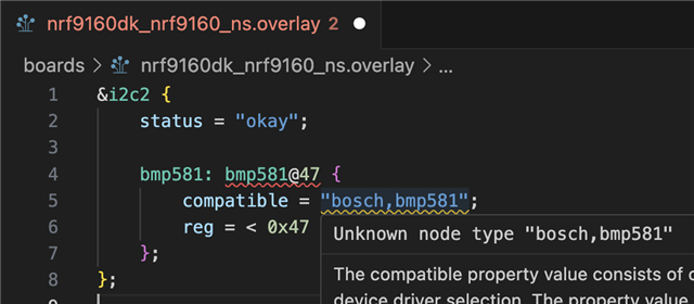

im trying to use the Bosch BMP581 I2C Sensor driver in Zephyr & NCS main. It's compiling and working fine but I get some warnings in VSCode that I was hoping you could help me track down. I should also say that I have gone though the sensor driver source code line by line and have compared with other drivers (that don't give VSCode warnings) and I can't see any problem with .h, .c, config or its bindings. It's really strange.
Here is what I am seeing in the board overlay in VSCode:
I can use just about any other sensor driver in my overlay and don't get any of these warnings.
Any suggestions on how I could track/trace these down?

  • I’m using NCS main which has the bmp581 driver and it’s working fine. It compiles and I’m able to read the pressure data. The problem is just with the swigging red and yellow lines in VSCode. I just can’t figure out why the extension isn’t aware of the sensor.
    the bma4xx sensor driver is an example of a recently added (to main) driver that also works fine and VSCode extension doesn’t show squiggly lines.

    Apparently, this is because the nRF Connect VS Code Extension couldn't handle the .yml file extension, which the bmp581 binding is using.
    I have noted this point with the extension team. For now, could you please change the bosch,bmp581.yml file to the .yaml extension instead?
