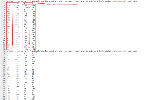

The number of IQ data printed at once seems to be limited.
Hi,I have encountered some problems:
hardware: nrf5340-dk
software:Visual Studio Code
ncs:2.5.0
sample: nrf\samples\bluetooth\direction_finding_central  &  direction_finding_peripheral (AoD mode)
issue:After successfully connecting two nrf5340dk, I attempted to print the received IQ data. Due to the fact that the code in the nrf library does not have the ability to print IQ data, I copy the code for printing IQ data from the zephyr library. However, when printing IQ data in the cteRecv_cb() function, actually, 46 messages should be printed at once, including one prompt message(such as:CTE[DF:51:35:BB:2D:FC (random)]: samples count 45, cte type AOD 2 [us], slot durations: 2 [us], packet status CRC OK, RSSI -300)and 45 IQ data pairs. But in fact, only a maximum of 25 pieces of data can be printed,and 21 messages dropped.The number of data printed at once seems to be limited. The tests I conducted afterwards also confirmed this, and I don't know where the code went wrong.
I modified the code and conducted several tests:
1.modified code in main.c:(copy the code for printing IQ data from the zephyr library)
static void cte_recv_cb(struct bt_conn *conn, struct bt_df_conn_iq_samples_report const *report)
	if (report->err == BT_DF_IQ_REPORT_ERR_SUCCESS) {
		printk("CTE[%s]: samples count %d, cte type %s, slot durations: %u [us], "
		       "packet status %s, RSSI %i\n",
		       addr, report->sample_count, cte_type2str(report->cte_type),
		       report->slot_durations, packet_status2str(report->packet_status),
		       report->rssi);
			for (uint8_t idx = 0; idx < report->sample_count; idx++) {
				if (report->sample_type == BT_DF_IQ_SAMPLE_8_BITS_INT) {
					printk(" IQ[%d]: %d, %d\n", idx, report->sample[idx].i,
					       report->sample[idx].q);
	} else {
		printk("CTE[%s]: request failed, err %u\n", addr, report->err);

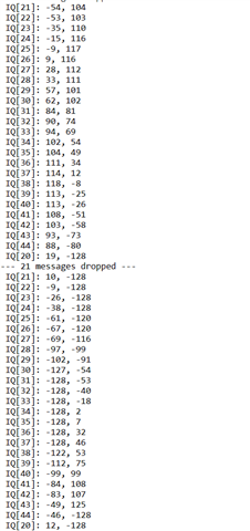

Serial port printing log:The first 21 messages were dropped
 IQ[20]: -128, 38
--- 21 messages dropped ---
 IQ[21]: -121, 44
 IQ[22]: -104, 87
 IQ[23]: -106, 86
 IQ[24]: -89, 102
 IQ[25]: -80, 110
 IQ[26]: -60, 124
 IQ[27]: -44, -128
 IQ[28]: -20, -128
 IQ[29]: -29, -128
 IQ[30]: 9, -128
 IQ[31]: 39, -128
 IQ[32]: 37, -128

 IQ[20]: -78, 87
 IQ[21]: -54, 104
 IQ[22]: -53, 103
 IQ[23]: -35, 110
 IQ[24]: -15, 116
 IQ[25]: -9, 117
 IQ[26]: 9, 116
 IQ[27]: 28, 112
 IQ[28]: 33, 111
 IQ[29]: 57, 101
 IQ[30]: 62, 102
 IQ[31]: 84, 81
 IQ[32]: 90, 74
 IQ[33]: 94, 69
 IQ[34]: 102, 54
 IQ[35]: 104, 49
 IQ[36]: 111, 34
 IQ[37]: 114, 12
 IQ[38]: 118, -8
 IQ[39]: 113, -25
 IQ[40]: 113, -26
 IQ[41]: 108, -51
 IQ[42]: 103, -58
 IQ[43]: 93, -73
 IQ[44]: 88, -80
 IQ[20]: 19, -128

2.modified code:(Print only the first 25 pairs of IQ data)
		       report->rssi);
			for (uint8_t idx = 0; idx < (report->sample_count-21); idx++) {
	} else {
Serial port printing log:(1 messages dropped )

 IQ[5]: 113, 21
 IQ[6]: -121, -5
 IQ[7]: 117, -10
 IQ[8]: -121, -2
 IQ[9]: -115, 12
 IQ[10]: -110, 41
 IQ[11]: -113, 29
 IQ[12]: -112, 46
 IQ[13]: -101, 68
 IQ[14]: -71, 95
 IQ[15]: -87, 80
 IQ[16]: -55, 103
 IQ[17]: -50, 105
 IQ[18]: -46, 108
 IQ[19]: -30, 113
 IQ[20]: -2, 118
 IQ[21]: -8, 120
 IQ[22]: 22, 116
 IQ[23]: 37, 114
 IQ[0]: -91, 82
--- 1 messages dropped ---
 IQ[1]: 91, -76
 IQ[2]: -96, 70
 IQ[3]: 100, -63
 IQ[4]: -101, 68
 IQ[5]: 91, -76
 IQ[6]: -85, 84
 IQ[7]: 84, -85
 IQ[8]: -82, 90
 IQ[9]: -60, 107
 IQ[10]: -62, 104
 IQ[11]: -36, 116
 IQ[12]: -23, 122
 IQ[13]: -20, 117
 IQ[14]: 5, 120
 IQ[15]: 7, 119
 IQ[16]: 50, 111
 IQ[17]: 53, 104
 IQ[18]: 65, 101
 IQ[19]: 61, 103
 IQ[20]: 76, 91
 IQ[21]: 102, 63
 IQ[22]: 101, 67
 IQ[23]: 111, 46
 IQ[0]: -128, -4
 IQ[1]: -128, -2
 IQ[2]: -126, 2
 IQ[3]: -128, -8
 IQ[4]: -128, 7
 IQ[5]: 126, -24
 IQ[6]: -126, 28
 IQ[7]: 123, -25
 IQ[8]: -121, 31
 IQ[9]: -116, 58
 IQ[10]: -110, 64
 IQ[11]: -94, 85
 IQ[12]: -87, 91
 IQ[13]: -70, 106
 IQ[14]: -52, 117
 IQ[15]: -48, 114
 IQ[16]: -39, 121
 IQ[17]: -4, 124
 IQ[18]: -8, 126
 IQ[19]: 19, 127
 IQ[20]: 30, 126
 IQ[21]: 43, 119
 IQ[22]: 57, 110
 IQ[23]: 74, 104
 IQ[0]: -60, 111
 IQ[1]: 57, -115
 IQ[2]: -37, 120
 IQ[3]: 36, -120
 IQ[4]: -33, 123
 IQ[5]: 41, -114
 IQ[6]: -40, 120
 IQ[7]: 21, -125
 IQ[8]: -12, 123
 IQ[9]: -9, 124
 IQ[10]: 18, 124
 IQ[11]: 42, 118
 IQ[12]: 42, 115
 IQ[13]: 52, 113
 IQ[14]: 89, 88
 IQ[15]: 66, 106
 IQ[16]: 96, 77
 IQ[17]: 100, 78
 IQ[18]: 115, 53
 IQ[19]: 122, 23
 IQ[20]: 121, 41
 IQ[21]: 124, 7
 IQ[22]: 126, 2
 IQ[23]: 122, -25
 IQ[0]: 4, -128

Based on the results of the previous three tests, I found that I can only print a limited number of times at a time. But I looked at other people's code on the forum and it was the same as mine, but I was able to print 45 pairs of IQ data at once. I don't know where the problem is.
4.Afterwards, I tried to modify the code again and successfully printed 45 pairs of IQ data. But the order of IQ data has changed, making it inconvenient for me to proceed with subsequent data processing. Here is the test I conducted:
modified code:(Print only 23 times)
/*definition*/
int IQ_data1[46]={};
int IQ_data2[46]={};
int IQ_data3[46]={};
int IQ_data4[46]={};
		       report->rssi);
			for (uint8_t idx = 0; idx < report->sample_count-22; idx++) {/*0-22*/
					IQ_data1[idx]=report->sample[idx].i;
					IQ_data2[idx]=report->sample[idx].q;
			for (uint8_t idx = report->sample_count-22; idx < report->sample_count; idx++) {/*23-44, its 22 is 0, so the printing result is correct*/
					IQ_data3[idx]=report->sample[idx].i;
					IQ_data4[idx]=report->sample[idx].q;
			for(int i=0;i<=22;i++){
				printk("%d\t%d\t%d\t%d\n",IQ_data1[i],IQ_data2[i],IQ_data3[i+22],IQ_data4[i+22]);
	} else {
Serial port printing log:(success
CTE[DF:51:35:BB:2D:FC (random)]: samples count 45, cte type AOD 2 [us], slot durations: 2 [us], packet status CRC OK, RSSI -420
55      25      0       0
-54     -29     -33     -54
55      30      -128    14
-62     -27     0       7
59      31      26      -31
-59     -27     -62     -38
60      23      100     -70
-51     3       -5      -5
-91     81      21      -48
4       6       -73     24
-5      49      58      -108
60      -13     0       -5
-25     127     -19     -47
-2      -2      -41     51
29      44      -32     -115
32      -51     -7      -5
13      -128    -39     -32
6       -8      -27     54
51      25      -84     -92
0       -65     -9      1
103     59      -51     -7
11      -9      33      54
44      -9      -121    -21
This is my entire code of main.c:
