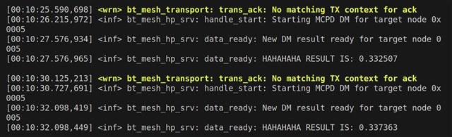

Distance measurement. NRF Mesh dm_cli and dm_srv communication issue:
I was trying to establish a mesh network to perform distance measurement and localization. The source code is available at https://github.com/nrfconnect/sdk-nrf/blob/main/subsys/bluetooth/mesh/vnd/dm_srv.c#L221 and https://github.com/nrfconnect/sdk-nrf/blob/main/subsys/bluetooth/mesh/vnd/dm_cli.c
The system consists of one central node, three beacons, and one target node.
Both the client and the servers were added to the mesh network through the NRF Mesh App.
The workflow of the system is introduced here: https://developer.nordicsemi.com/nRF_Connect_SDK/doc/latest/nrf/libraries/bluetooth_services/mesh/vnd/dm_srv.html
The issue occurred when the client asked the servers to start distance measurement and then waited for a response. During this process, the client would sometimes face a timeout error or get stuck (meaning there were no errors returned, but the system was suspended).
More specifically, the requests could be successfully sent to the beacons, signaling them to begin the measurement process. The beacons were also able to accurately obtain the distance data. However, the beacons failed to transmit this data back to the central node, which is an issue we have been debugging for a long time.
Currently, we are testing with one target, one central node, and two beacons to see whether the central node can receive the correct measured distances transmitted by the two beacons.
Here is the output of one of the beacons:
Here is the output from the central node. We can clearly observe that in the first iteration, the central node attempts to retrieve results from the two beacons individually. It successfully prints out the two addresses (0x6 and 0x8). However, a timeout error prevents the information from being updated. In the second iteration, the system gets stuck at 0x6 and does not continue to inquire about the other beacon. At the same time, the beacons could continue measuring the distance and displaying the distances even though the output was stuck at the client (which was confusing for me).
