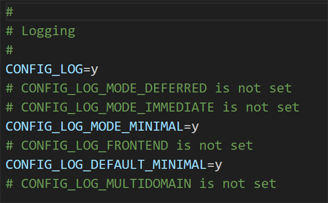

    OK, this is my proj.conf settings for logging:
    And this is the relevant section of the .config file:
    That won't fit into my available flash space, so bombs out.  This is the full error message:
    I tried with a few samples, and other code I have.  I can definitely see a difference in the total amount of Flash consumed between having CONFIG_LOG_MODE_MINIMAL=y compared to CONFIG_LOG_MODE_MINIMAL=n
    Interestingly, if I set CONFIG_LOG_MODE_MINIMAL=y, I'm over-sized by 2148 bytes, but if I set
    CONFIG_LOG_MODE_MINIMAL=n, I've oversized by 12784 bytes, which is about the 11kB difference I've been seeing.  Just can't work out why I'm going over my Flash limit in the first place.
    Putting CONFIG_LOG=n, means I'm about 16kB less in total Flash than if I set CONFIG_LOG=y and CONFIG_LOG_MINIMAL=y.

    Seems to be suggesting that even though I'm setting CONFIG_LOG_MODE_MINNAL=y, its not actually being set to that.
    But in my .config under build/zephyr I see this:
    which is suggesting its been set to what I want.
