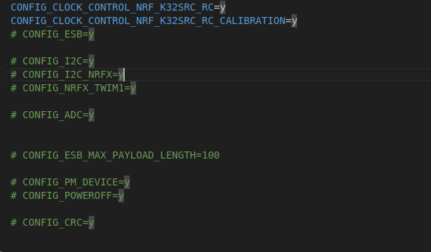

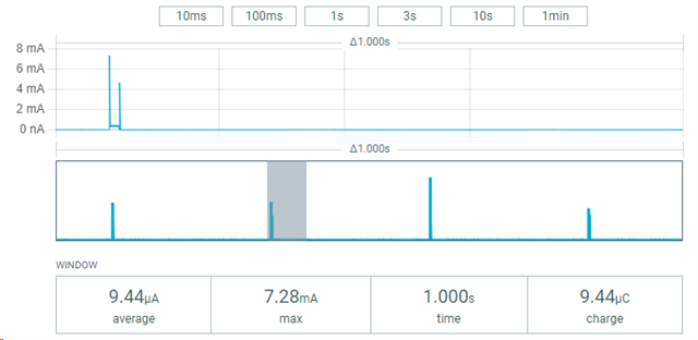

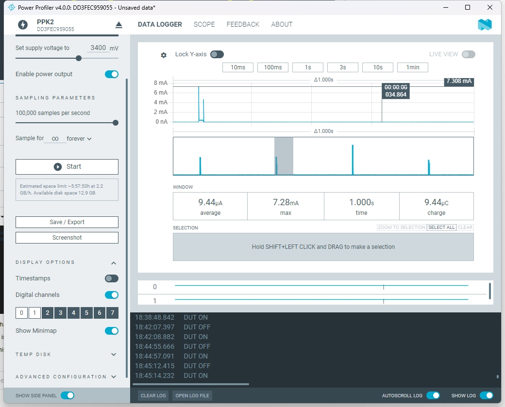

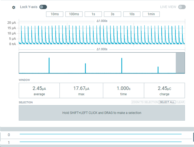

My chip is battery powered, so I need very low power, and when I try to play with the code, the PPK2 device always gets weird spikes.
prj.conf

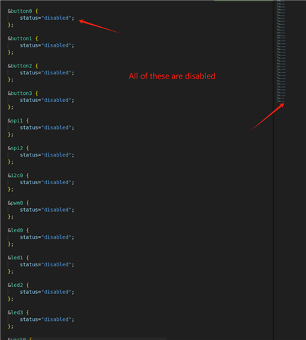

overlay

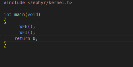

main.c

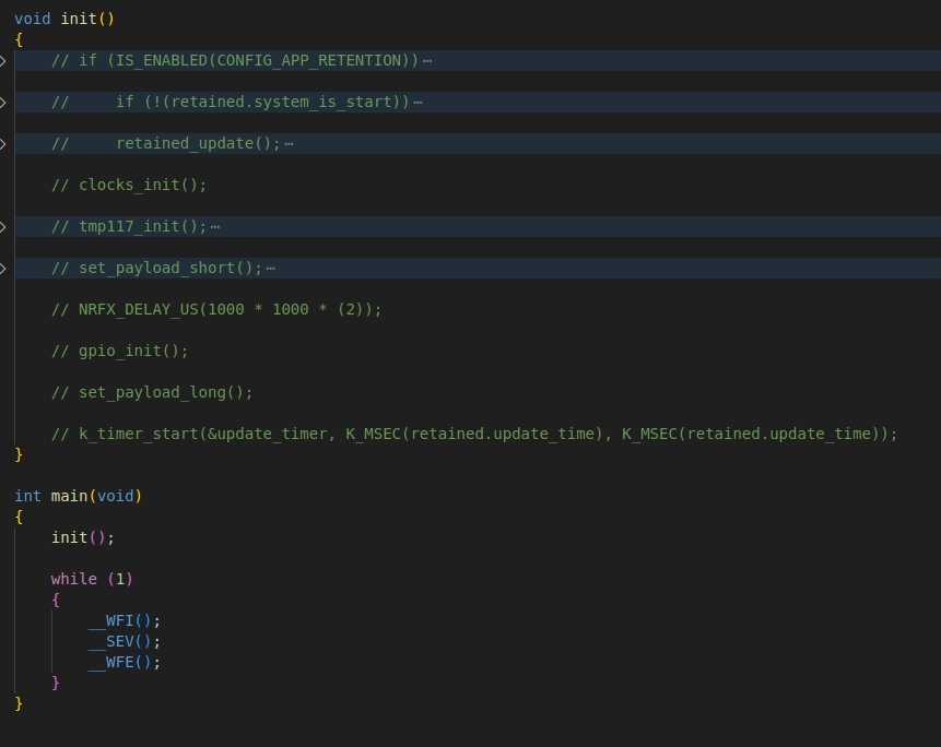

I have no idea how I would change this, even though I have completely commented out all the code that could be commented.
When I try to recreate a new empty program, the spike is gone, but if I change the device tree file and the CONFIG file based on it, it happens again, even if I comment it out again.
When I use bare-metal applications (without zephyr), this doesn't happen.
    The LFRC source is calibrated periodically against the HFXO to acheive 500 ppm accuracy required for BLE. Calibration can be turned off by adding CLOCK_CONTROL_NRF_K32SRC_RC_CALIBRATION=y to your prj.conf file.
    Also, you should remove the while loop you have in main() to allow the idle thread to run. The idle thread will call __WFE() to allow the chip to enter System ON (sleep).
