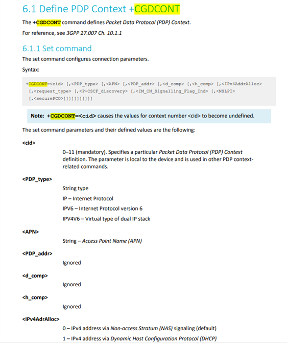

1. Is the nRF9160 SLM supports NIDD(non-ip data delivery)? If yes, can you please provide the AT commands to configure NIDD.

  • Yes, did you see the following content in the page I point to?
    Here is a sample configuration for NIDD connection in the slm_auto_connect.h file:
    /* Network-specific default system mode configured by %XSYSTEMMODE (refer to AT command manual) */
    0,        /* LTE support */
    1,        /* NB-IoT support */
    0,        /* GNSS support, also define CONFIG_MODEM_ANTENNA if not Nordic DK */
    0,        /* LTE preference */
    /* Network-specific default PDN configured by +CGDCONT and +CGAUTH (refer to AT command manual) */
    true,     /* PDP context definition required or not */
    "Non-IP", /* PDP type: "IP", "IPV6", "IPV4V6", "Non-IP" */
    "",       /* Access point name */
    0,        /* PDP authentication protocol: 0(None), 1(PAP), 2(CHAP) */
    "",       /* PDN connection authentication username */
    ""        /* PDN connection authentication password */
