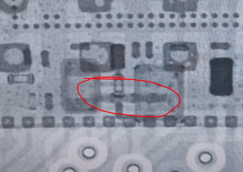

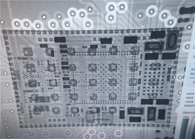

  • 1. We have 5 total in the prototype batch, 4 of the 5 are having this issue.
    2. I loaded modem FW v1.2.2 and got the same result.
    3. We have tried reworking one unit via hot air. However, the SiP is a very difficult package to rework. Our first attempt did not yield any difference. However, we are still planning to have some of these units X-rayd for solder quality.
    Although this may be a solder quality issue, I still want to understand the areas we should be looking at. It sounds like DEC0 is possibly one of the pins to take a look at. I have checked the voltage on the 4.7uF DEC0 capacitor under operation and it seemed to be in the same range as other boards we have that are functional.
    What other hardware related items could we check while we wait on the X-ray?
    Thanks
    That is correct. DEC0 is critical for the startup of the nRF9160. As for other signals, it is hard to pin-point exactly what has gone wrong in this case.
    Have you checked your voltages and current consumption of your board as a whole compared to the working sample? That can give an indication.
    Håkon
