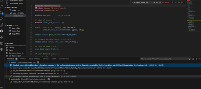

I am trying to program Event Driven State Machine Example using zephyr RTOS into nrf52833 Nordic Board. The issue I am facing is that code is not building (FAILED: zephyr/zephyr_pre0.elf zephyr/zephyr_pre0.map). Basically, all my transitions follow the same pattern. I tried to figure out this with exactly same sample code provided in this site (State Machine Framework — Zephyr Project documentation (nRF Connect SDK) (nordicsemi.com)) and I am using the SDK version is v5.2.2. could you please provide any insights, resources or methods that could help me to execute the sample code.

    This is the code i'm trying to build and it is from the webpage mentioned in the original question.
    And this is the error log from build terminal window.
    Building blinky_2
    C:\Windows\system32\cmd.exe /d /s /c "west build --build-dir c:/Users/Marina/blinky_1/blinky_2/build c:/Users/Marina/blinky_1/blinky_2"
    [1/6] Linking C executable zephyr\zephyr_pre0.elf
    cmd.exe /C "cd . && C:\ncs\toolchains\c57af46cb7\opt\zephyr-sdk\arm-zephyr-eabi\bin\arm-zephyr-eabi-gcc.exe -gdwarf-4 zephyr/CMakeFiles/zephyr_pre0.dir/misc/empty_file.c.obj -o zephyr\zephyr_pre0.elf -fuse-ld=bfd -T zephyr/linker_zephyr_pre0.cmd -Wl,-Map=C:/Users/Marina/blinky_1/blinky_2/build/zephyr/zephyr_pre0.map -Wl,--whole-archive app/libapp.a zephyr/libzephyr.a zephyr/arch/common/libarch__common.a zephyr/arch/arch/arm/core/aarch32/libarch__arm__core__aarch32.a zephyr/arch/arch/arm/core/aarch32/cortex_m/libarch__arm__core__aarch32__cortex_m.a zephyr/arch/arch/arm/core/aarch32/mpu/libarch__arm__core__aarch32__mpu.a zephyr/lib/libc/picolibc/liblib__libc__picolibc.a zephyr/lib/libc/common/liblib__libc__common.a zephyr/lib/smf/liblib__smf.a zephyr/soc/soc/arm/common/cortex_m/libsoc__arm__common__cortex_m.a zephyr/soc/soc/arm/nordic_nrf/nrf52/libsoc__arm__nordic_nrf__nrf52.a zephyr/subsys/usb/usb_c/libsubsys__usb__usb_c.a zephyr/drivers/clock_control/libdrivers__clock_control.a zephyr/drivers/console/libdrivers__console.a zephyr/drivers/gpio/libdrivers__gpio.a zephyr/drivers/i2c/libdrivers__i2c.a zephyr/drivers/pinctrl/libdrivers__pinctrl.a zephyr/drivers/serial/libdrivers__serial.a zephyr/drivers/timer/libdrivers__timer.a modules/nrf/lib/fatal_error/lib..__nrf__lib__fatal_error.a modules/hal_nordic/nrfx/libmodules__hal_nordic__nrfx.a modules/segger/libmodules__segger.a -Wl,--no-whole-archive zephyr/kernel/libkernel.a zephyr/CMakeFiles/offsets.dir/./arch/arm/core/offsets/offsets.c.obj -L"c:/ncs/toolchains/c57af46cb7/opt/zephyr-sdk/arm-zephyr-eabi/bin/../lib/gcc/arm-zephyr-eabi/12.2.0/thumb/v7e-m/nofp" -LC:/Users/Marina/blinky_1/blinky_2/build/zephyr -lgcc zephyr/arch/common/libisr_tables.a -mcpu=cortex-m4 -mthumb -mabi=aapcs -mfp16-format=ieee -Wl,--gc-sections -Wl,--build-id=none -Wl,--sort-common=descending -Wl,--sort-section=alignment -Wl,-u,_OffsetAbsSyms -Wl,-u,_ConfigAbsSyms -nostdlib -static -Wl,-X -Wl,-N -Wl,--orphan-handling=warn -Wl,-no-pie -DPICOLIBC_INTEGER_PRINTF_SCANF --specs=picolibc.specs -lc -lgcc && cmd.exe /C "cd /D C:\Users\Marina\blinky_1\blinky_2\build\zephyr && C:\ncs\toolchains\c57af46cb7\opt\bin\cmake.exe -E true""
    c:/ncs/toolchains/c57af46cb7/opt/zephyr-sdk/arm-zephyr-eabi/bin/../lib/gcc/arm-zephyr-eabi/12.2.0/../../../../arm-zephyr-eabi/bin/ld.bfd.exe: app/libapp.a(main.c.obj): in function `k_event_set':
    C:\Users\Marina\blinky_1\blinky_2\build/zephyr/include/generated/syscalls/kernel.h:828: undefined reference to `z_impl_k_event_set'
    c:/ncs/toolchains/c57af46cb7/opt/zephyr-sdk/arm-zephyr-eabi/bin/../lib/gcc/arm-zephyr-eabi/12.2.0/../../../../arm-zephyr-eabi/bin/ld.bfd.exe: C:\Users\Marina\blinky_1\blinky_2\build/zephyr/include/generated/syscalls/kernel.h:828: undefined reference to `z_impl_k_event_set'
    c:/ncs/toolchains/c57af46cb7/opt/zephyr-sdk/arm-zephyr-eabi/bin/../lib/gcc/arm-zephyr-eabi/12.2.0/../../../../arm-zephyr-eabi/bin/ld.bfd.exe: app/libapp.a(main.c.obj): in function `k_event_init':
    C:\Users\Marina\blinky_1\blinky_2\build/zephyr/include/generated/syscalls/kernel.h:794: undefined reference to `z_impl_k_event_init'
    FATAL ERROR: command exited with status 1: 'C:\ncs\toolchains\c57af46cb7\opt\bin\cmake.EXE' --build 'c:\Users\Marina\blinky_1\blinky_2\build'
  • So, this is a project you have created yourself. Have you added CONFIG_EVENTS=y to your prj.conf file to enable event objects ( this includes the file which implements `z_impl_k_event_init')
  • Tried by adding configuration (CONFIG_EVENTS=y), but still not building. Could you please figure out why the header is not taking. (#include <zephyr/kernel.h>)
    Thankyou!
  • What is the build error reported in the build output now? The errors shown in in your last screenshot should be resolved once you are able to build the project.
