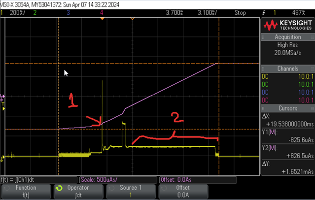

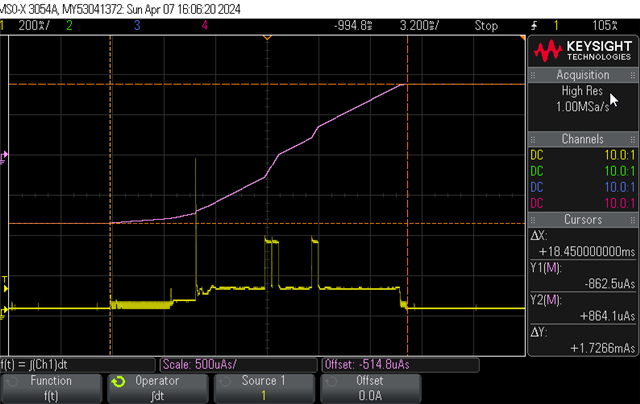

here are some result of power profile:
sending 1 packet on 1 channel.  ~20ms.
sending 3 packets on same channel (without ch switching) ~20ms
sending 3 packets with channels switching - ~752ms
some point to look at:

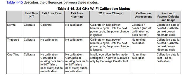

1. what is "1" peak.  is this Wifi calibration?
if so, we need a way to control this.
TI cc3x20 offers 3 modes for calibration
Normal, Triggred, On-time - see link to TI network processor.
https://www.ti.com/lit/ug/swru455m/swru455m.pdf?ts=1711606377096&ref_url=https%253A%252F%252Fwww.ti.com%252Fproduct%252FCC3130
2. after transmitting, why does the chip keep on staying awake?
see "2" in image above. - we need minimum time soc is awake for max power optimization

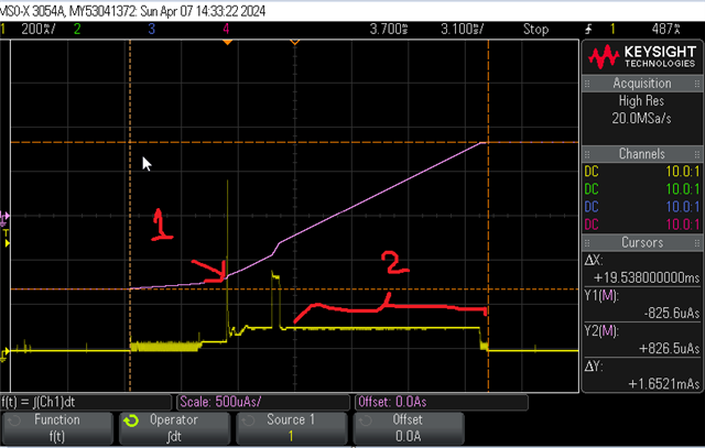

    What is around 20 ms?
    Could you please provide more information about the screenshot below - which case does it cover and what is shown in the picture?
    between each packet within the 1,6,11 burst we try to send as fast as we can.
    Could you describe in detail how you transfer packets? Are you sending anything between packets?
    Dejan
    This image you selected is the first case in my question -  sending 1 packet on 1 channel.
    this has been done with Nordic's example without code changes.
    the screenshot shows, a single packet sent over wifi.
    the next packet sent  (not captured) will be seen in 1 second.
    configuration to example code was:
    CONFIG_RAW_TX_PKT_SAMPLE_RATE_FLAGS 0 // Legacy mode (802.11g)
    CONFIG_NRF_WIFI_LOW_POWER=y
    I retested this and confident with this result.
    appreciate your support!

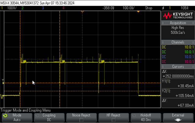

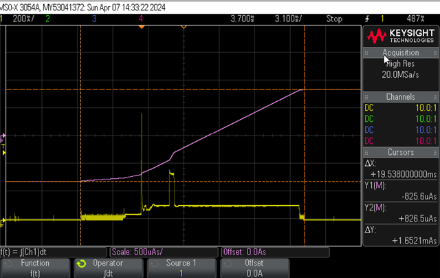

  • Hi Dejan - thanks for reply!
    when you send a packet / or packets, this is considered an event. The event triggered a capture on the scope of the current drawn at that time. The images I shared show respectively what happens in different types of events.
    setup was: nrf7002-dk connecting a current prob to P23 jumpers, and gave power 3.6v to P21 as explained in documentation.
    20ms is the total time of event for 1 channel and 1 packet , you can see on scope with the time division, how long the entire event took.
    752 ms is the total time of event, for sending 3 packets on 3 different channels.
    The scope images are showing what the device is doing for just sending a wifi packet. The application code doesn't do anything else -see example raw packet source code.

    [ch1, ch6, ch11]  [sleep 1000ms ] [ch1, ch6,ch 11] [ sleep 1000ms]  loop forever...
    thanks
    Dan
  • Hi Dan,
    Thank you for providing additional information.
    Could you also answer remaining questions (shown below)?
    dejans said:
    Could you provide your "west build" command?
    EDIT:
    What is the duration of the second interval labeled "2" in your screenshot?
    Do you use connected mode?
    Can you provide your project configurations in different cases for which you provided screenshots?
    Dejan
    Dejan

    label2:
    ~10ms

  • Hi Dan,
    Regarding your first question, the existence of the peak in your screenshot (marked "1") could be the result of charging external capacitor when turning on specific internal regulator.
    We will look into this issue further during next week. I hope to provide you with some information by the end of the next week.
    Dejan
