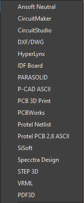

Btw, Altium has a supported importer for migrating Eagle projects/libs into their software but Autodesk has no such equivalent feature: Basically, our only option is to attempt to replicate Nordic's layout from scratch and hope that our fabricated boards might work half as well... Should nobody end up sharing, my plan-B will be to modify this nRF52832-QFAA Eagle adaptation of Nordic's ref layout to use the WLCSP package. I'll then replace all the other components that differ between the existing Altium CIAA & QFAA ref layout's BoMs. If it comes to this, I'll make sure to share my Fusion files here.
