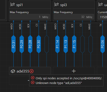

I have been trying to initialize my driver for the adxl355. I copied almost everything from the lesson 7 exercise 1 of the nrfConnect intermediate course.
For some reason, when I compile I get:
 undefined reference to `__device_dts_ord_132'
Which when I entered the device tree, is my custom device. Also, when I open the .overlay file I get this errors:
So I guess I am not including correctly my overlay or the drivers for my device.
I will include the .zip file of my project in case it is needed.

  • Hi Håkon,
    Thank you so much for your answer, it was really helpful. Now it is building. Just to add, I also had to add in my prj.conf file CONFIG_SENSOR = y.
    Now I am getting this warnings, which I hope are nothing to be worried about.

    Adrian1504 said:
    I am not able to connect to the COM ports: Opening COM5: Access denied.
    This is highly likely because another process has the COM port open, and is completely separate from the firmware running on the nRF.
    Opening/closing a COM port is on your computer side.
    The warnings emitted should not be ignored. They are crucial to handle in order to get the sensor up and running, as you're packing the data into too small buffers/data types.
    Håkon
