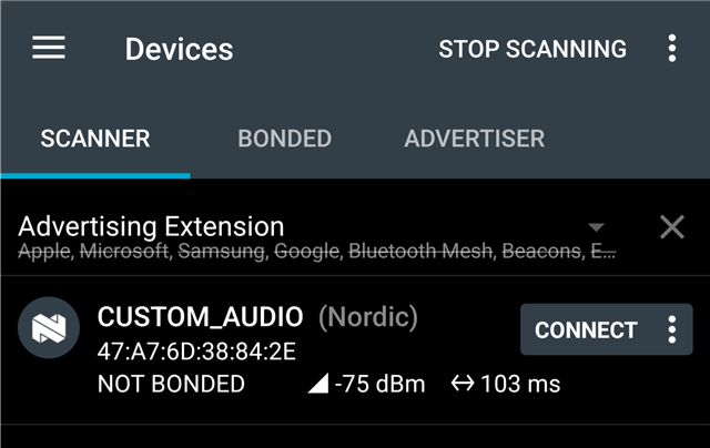

    Also when I try to modify any thing from the scanner (as I want to adv from my device with some other name so I replaced CONFIG_BT_DEVICE_NAME  in https://github.com/nrfconnect/sdk-nrf/blob/v2.6.0/applications/nrf5340_audio/unicast_client/main.c#L501) and also intentionally added some extra charat after the ; and observed that my west build is still passing and not giving any error
    So I think that the file is not a part of the bulild.
    Please guide me here to modify the code so that from Gateway (unicast client) I can modify and make it able to scan any other keyword.
    I have tried to reproduce the issue, but so far I am not having any issues with scanning for the advertisements. This is my method:
    • Add
      config BT_DEVICE_NAME
      default "CUSTOM_AUDIO"
      to nrf5340_audio/unicast_server/Kconfig.defaults
    • Change https://github.com/nrfconnect/sdk-nrf/blob/v2.7.0/applications/nrf5340_audio/unicast_client/main.c#L571-L572 to
      ret = bt_mgmt_scan_start(0, 0, BT_MGMT_SCAN_TYPE_CONN, "CUSTOM_AUDIO",
      BRDCAST_ID_NOT_USED);
    • Build and flash the application with
      python .\tools\buildprog\buildprog.py -c both -d both -b debug --pristine -p -f
       from the nrf5340_audio directory.
    • Observe that the headset connects to the gateway.

    • Turn off the gateway and reset the Headset with deleted bonding information.
    • Use the nRF Connect for Android app (v4.28.1) on a Pixel 7 Pro (Android 14) to scan for the headset advertisements.
      • Verify that the advertisements are successfully scanned by the phone:
