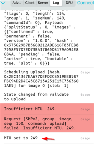

We have noted that in our project a DFU triggered by the iOS app is very slow, achieving 0.1 -0.2 kbps.
Whereas DFUs initiated by the Android app are achieving the expected ~5-7kbps
Running nRF Connect SDK v2.5.1 on a custom board with an nRF52832; utilizing external flash.
We have found:
1. The iOS app logs report an MTU exchange error.
However, Wireshark has shown that this is unrelated to an actual MTU exchange. The MTU exchange actually occurs on first connection in the iOS app. Starting the DFU reports this error into the log, while no MTU request is actually sent.
Initiating this via the slave, and allowing the app to initiate this both yield in the same log.
2. Wireshark shows there are large 10 second breaks in traffic when running the DFU.

The very first time this occurs in a DFU, the update response is successful. Subsequent ones (which always happen after every 10s break) report failures.
4. We have noted that a successful DFU on Android has different size packets than the iOS (277 size writes on Android, 272 as per logs above on iPhones)
Can anyone comment as to this behaviour and any possible workarounds?
We have validated that the MTU size of 247/249 (tested both) is successfully set on Android and PC apps. By the look of the size of the packets on the sniffer, it seems to us that the MTU size being used is indeed 249.

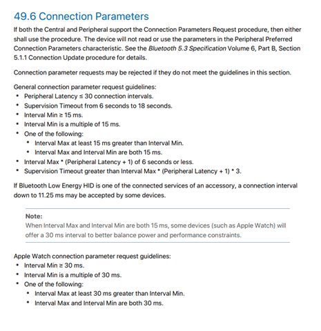

    Please try with the following configuration:
    CONFIG_MCUMGR_TRANSPORT_BT_CONN_PARAM_CONTROL=y
    CONFIG_MCUMGR_TRANSPORT_BT_CONN_PARAM_CONTROL_MIN_INT=12
    CONFIG_MCUMGR_TRANSPORT_BT_CONN_PARAM_CONTROL_MAX_INT=12
    Which is in line with Apple's recommondations here:
    https://developer.apple.com/accessories/Accessory-Design-Guidelines.pdf
    This should ensure that the connection update request is accepted.

    The change to Parameters did stop point 3 in the original post, thanks!
