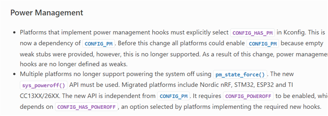

I've done a bit of digging, and it looks like in Zephyr 3.5.0 (I think NCS V2.6.0 uses Zephyr 3.5.99) they implemented some changes to how power management is enabled and invoked:
So, that looks like rather than needing to have CONFIG_PM=y in my proj.conf, I need to have CONFIG_POWEROFF=y.  And then, rather than call pm_state_force(), I have to call sys_poweroff().

    I'm sorry to hear you have had this many challenges with the migration. Support for the PM subsystem was removed in SDK v2.5.0. The reasoning for this change was given in the commit message here: https://github.com/nrfconnect/sdk-zephyr/commit/96b38273138f05dd06cf7a58fa361f401e773e5e. Unfortunately, this change was not mentioned in the release notes or migration documentation.
    In addition to enabling CONFIG_POWEROFF, did you include the poweroff.h header (#include <zephyr/sys/poweroff.h>) in the source file that calls the function?
