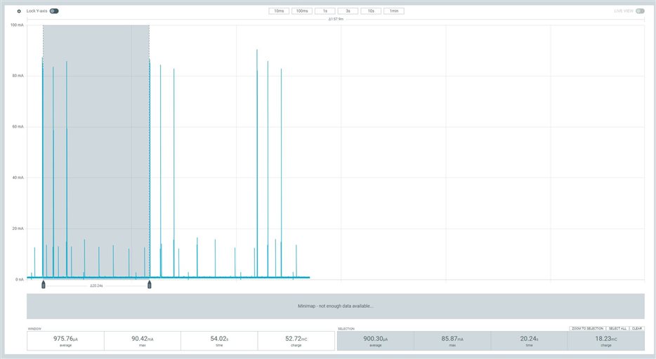

I'm evaluating NRF9160 DK board and have faced current consumption problems. My device keeps consuming over 2mA while in eDRX idle.
eDRX cycle length seems to be OK, but I wonder what could cause idle power spiking? If I'm not wrong I should get low as ~10uA in eDRX idle or am I completely wrong?
I'm quite new with NRF91 and Zephyr so please ask any additional questions. I'm out of ideas what to try next. Do you have any ideas where my problem might be?

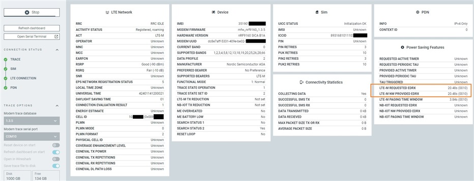

picture (1) Cellular monitor view

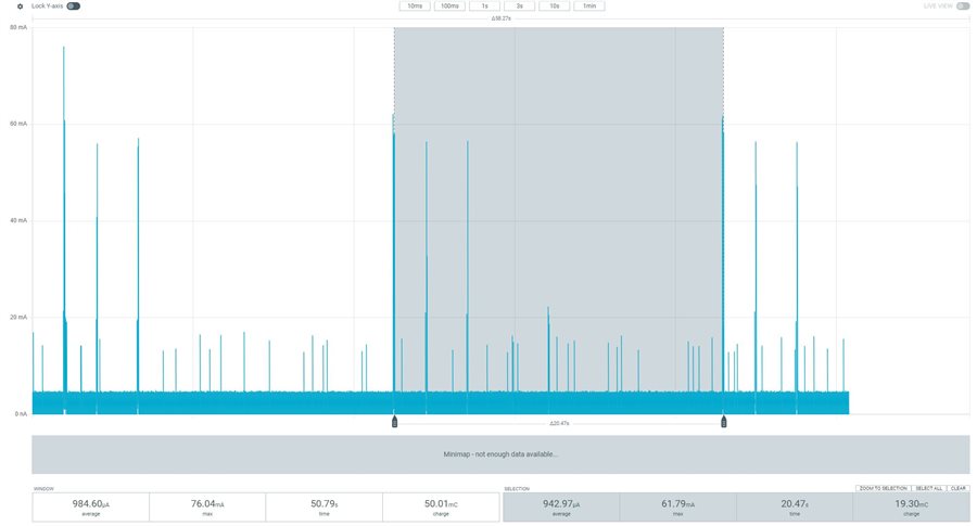

picture (2) zoomed out while powered via USB while running Cellular monitor.

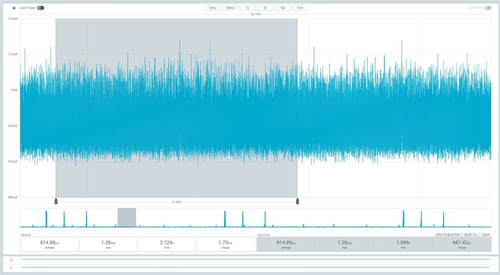

picture (3) image shows USB-powered current consumption while running Cellular monitor.
Picture (4) shows overview while running AWS MQTT example and is using lithium battery. eDRX period seems to match.

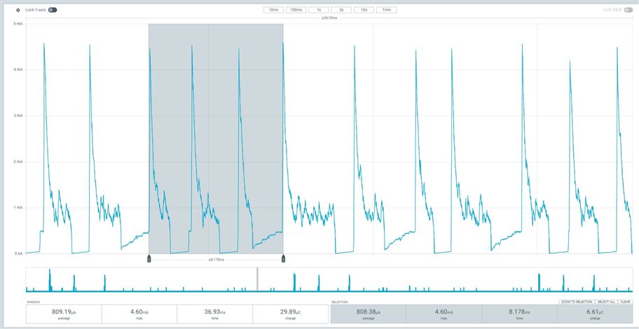

Picture (5) Shows zoomed in power consumption running AWS MQTT example and using lithium battery.
