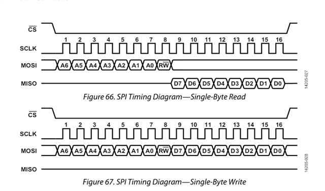

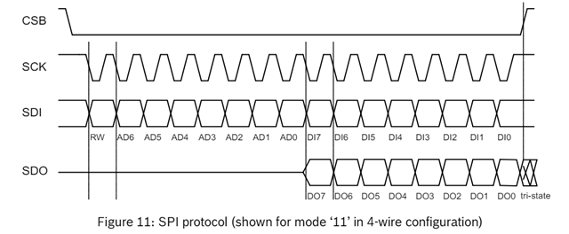

    I was going through the datasheet (SPI diagrams) of the BME280 from the intermediate course and compared a little with the datasheet from the ADXL355. I noticed that the R/W bit for the ADXL355 goes in the end:
    ADXL355:
    BME280:

  • Hi Adrian,
    Thank you for going through the datasheets and making comparisons.
    Yes, indeed, that would be the case and you will have to update the code accordingly.

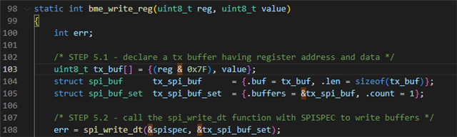

    For example, (BME Example from the intermediate course),
    you can see that for writing, the 8th bit [b7 from b7...b0] is set as 0 in line 103 while for reading it is left 1.
    So yes, please make suitable changes as per your own sensor and datasheet.

  • it should be:
    //For writing
    //0 will be inserted through shift left operation
    //otherwise, you can also do the & operation with 0xFE (that will set b0=0)
    uint8_t tx_buf[] = {(reg << 1), value};
    //For reading
    //setting b0=1 through OR operation
    uint8_t tx_buffer = ((reg << 1) | 1);
    please test as per your own code.
