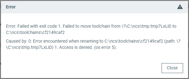

I'm trying to install nRF Connect v2.6.0, using either:
- VS Code + nRF Connect extension (source)
- nRF Connect for desktop + toolchain manager
- nrfutil toolchain-manager.
The installation fails with the following error (nRF Connect for desktop )
and similar for the CLI and VS Code:
$ nrfutil toolchain-manager install --ncs-version v2.6.0
[00:00:03] ###### 100% [Download toolchain] Finished, using previously downloaded file
[00:01:55] ###### 100% [Unpack toolchain] Toolchain unpacked to C:\ncs\tmp\.tmpceX8IH
Error: Failed to move toolchain from \\?\C:\ncs\tmp\.tmpceX8IH to C:\ncs\toolchains\cf2149caf2
Caused by:
    0: Error encountered when renaming to C:\ncs\toolchains\cf2149caf2 (path: \\?\C:\ncs\tmp\.tmpceX8IH)
    1: Access is denied. (os error 5)
I'm using Windows 11 Pro, up-to-date, all the application were started as "run as administrator".

From my understanding, OS Error 5 is a permission issue, but I can't figure out what is causing that, and how to change it.
Does one of you have any idea?
