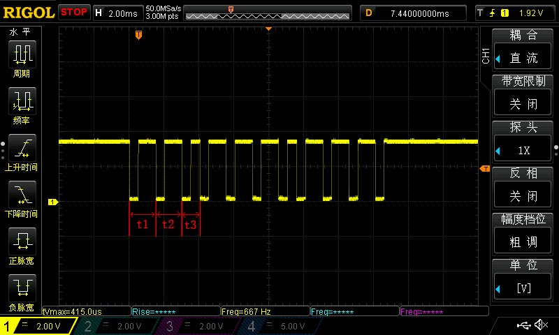

nrf51822 gpiote and timer capture pulse width
Hi: I want to capture the parameter of a digital wave like this, I want to get every 't' value. The wave is same in a period of time, but the 51822 capture value of 't' is shaking(the right value is 1500us,and 51822 capture value is 1400 to 1600us random ). I use nrf_drv_gpiote and nrf_drv_timer.My code is as follow. Can you give me some suggestions.
image description
function inital

PS: the dtime is the value I want. Please give me some suggestion. Thank you!
