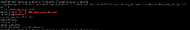

    Have you already broadcasted the packets that used liblc3 to encode, and not satisfied the quality? Or are you using liblc3 to enc and dec on PC, and not satisfied with the quality? If it is the last, there could be a chance that the bitrate that liblc3 is using is for stereo channel:
    e.g., if we use liblc3 for enc wav with 32kbps, that means 16kbps for L and 16kbps for right channel.
    So probably you can make a trial by doubling the bitrate, and also check if the encoded frame size for each channel is 40 bytes.
