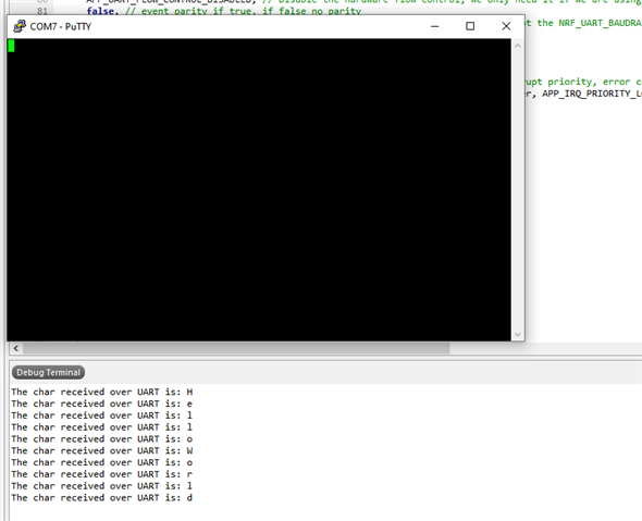

  • This is what I see when running your application on a DK:
    I can write in the UART terminal (Putty), and it is printed in the UART log from the nRF.
    By default, the printf will print using RTT (which is not UART). This is why you can see it in the debug terminal in Segger Embedded Studio. If you want printf to be printed over UART instead, you need to enable it from sdk_config.h by setting:
    #define RETARGER_ENABLED 1
    (find it and change from 0 to 1)
    Then the printf() messages will be printed over UART (putty) instead of RTT.
