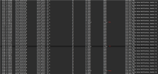

By sniffering the communication, I noticed that Central sends frequently empty PDU each 150us, and after around 10 packets, a delay of around 1733us till the Master sends an empty PDU before the slave starts again to transmit data.
What I expected here is that an event packet or empty pdu should never be sent since the peripheral keeps transmitting data each 450us (data size = 35 bytes including all ble headers).
here are the connection, extension length and MTU parameters
What should I do to avoid those empty PDU packets and force peripheral to keep sending packets each 450us?

    Indeed the delay is not the best way to get a very accurate delay but this is only for demonstration purpose. I don't think that those empty PDUs occur bc of this delay, this delay is only in microseconds and I have max connection event extension of 4 ms and a connection interval of 7.5 ms, so theoretically the PDU should be applied only if there is no communication within 4 ms right? but now the empty pdu is transmitted by Master each 150us right after the notify events by the slave and each 8 empty pdu packets a big delay of around 1736us appears. This delay happens consistently (not randomly seems like).
    Anyway I implemented your advice by using a timer and semaphore where 16 packets are sent without delay and after that wait 50ms again before sending the next 16 packets without any delay but unfortunately, the problem is still there.

    I think what you are seeing here is just the end of the connection event. Typically the SoftDevice controller will reserve around 2ms at the end of each event for post processing etc.
    If you try with a longer connection interval (try somewhere around 15-30ms for instance) you might get longer bursts of packets without delay.
    Please note that if the link quality is poor, and you drop one of the packets in the sequence, the rest of the connection event will be lost and you won't be able to transmit anything else until the next connection event. So in poor RF conditions a shorter connection interval might be better.
    And if high throughput is the overall goal I would recommend combining multiple packets into one, in order to more efficiently use the radio. The ideal situation is to negotiate 251 byte data length and send 244 byte packets (leaving 7 bytes for the ATT and L2CAP headers).
