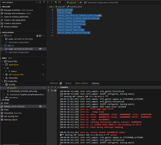

    To avoid confusion I am using the sample app nrfx at c:\ncs\v2.6.1\zephyr\samples\boards\nrf\nrfx\
    :/mnt/c/ncs/v2.6.1/zephyr/samples/boards/nrf/nrfx/build/zephyr$ addr2line -e zephyr.elf 0x0000065c
    C:\ncs\v2.6.1\zephyr\samples\boards\nrf\nrfx\build/C:/ncs/v2.6.1/zephyr/samples/boards/nrf/nrfx/src/main.c:38
    Do i need any other config  to get this non-halting debugging working ?
    screen shot of the prj.conf along with error
  • The issue seen only when breakpoint is set in IRQ handlers?
    Also same issue is seen with halt debugging also
    Is there any limitation  to out breakpoint in IRQ handler with Segger debugger?
    Any remedy ?
    Yes, there can be issues when setting a breakpoint inside an IRQ handler or during haltmode debugging. This has been discussed in this forum before, and I guess this is not a limitation of the segger debugger but rather the nature of the interrupt handler and debugging in halt mode. Take a look at this old thread. This thread is also discussing something very similar.
