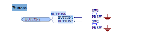

I`m a beginner, try to test the Lesson2 exercise 1 code of nRF Connect SDK Fundamentals, it´s about LED and buttons.
Thingy53 I`m using, this is the schematic, theoritcally, if button(SW3) is pressed, it´s connected to ground, namely, logic 0.
button in the code, I actually get logic 1, when the button is pressed, this confuses me, why???

    I see that you've resolved this yourself already, and yes, you're right. This it how it works.
    You can for instance use the overlay (also explained in the fundamentals course) to change if a GPIO should be active high or active low, to revert this. You can also use the devicetree helper in the VS Code extension to visually see what is happening and these configurations will get directly added to your overlay files if you want to modify something.
