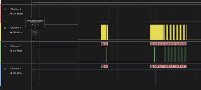

I am trying to get the nRF Connect (Zephyr) fs_sample working with nRF5340 preview DK, but am getting the following errors:
*** Booting nRF Connect SDK d96769faceca ***
[00:00:00.258,697] <err> sd: Card error on CMD0
[00:00:00.258,728] <err> main: Storage init ERROR!
[00:00:00.264,343] <err> sd: Card error on CMD0
[00:00:00.264,343] <err> fs: fs mount error (-5)
Error mounting disk.
[00:00:00.264,404] <err> fs: fs not mounted (mp == 0x20000000)

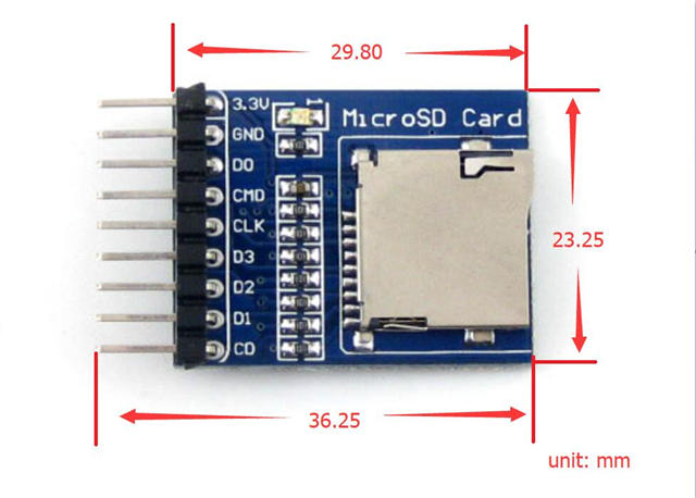

SD Card Details
1. 8GB SD card formatted with FAT.
2. Waveshare microSD adapter with following connections:
CS - P1.12 - D3
MOSI - P1.13 - CMD
MISO - P1.14 - DO
SCK - P1.15 - CLK
SPI data from logic analyzer:

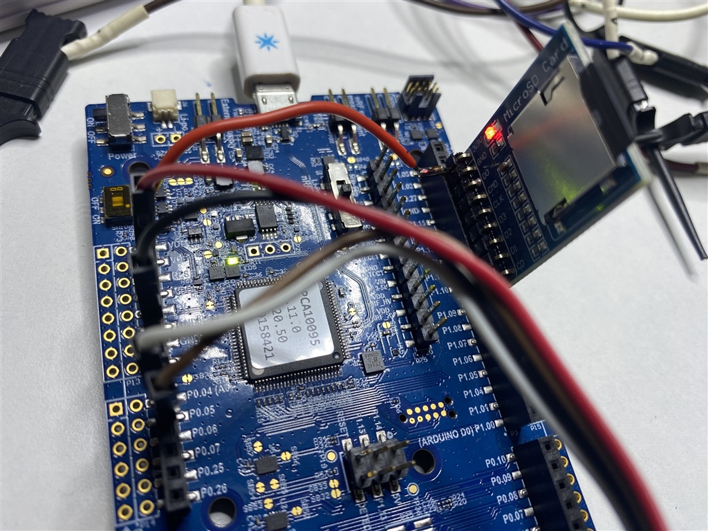

  • Just a quick update for anyone reading this. I was able to get SD card to work with the nRF5340 preview DK by doing two things:
    1. Shorter lines (plug in directly) for SPI
    2. Increase stack size.
    Here's a pic!
