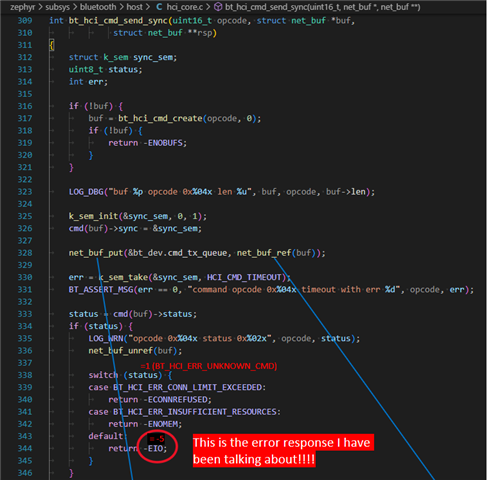

Hey,
After updating the nRF Connect SDK v2.60 (from 2.3.0) package an attempt to turn a BLE carrier ON by sending the BT_HCI_OP_LE_TX_TEST_v4 DTM command over the HCI interface by calling the bt_hci_cmd_send_sync() function just keeps on returning the -EOI (-5) error response (the status byte returned is BT_HCI_ERR_UNKNOWN_CMD = 1).
We have the nRF5340 chip in our device and this same test was working just fine before the update. On the BLE controller we are running For the test we have just added the following config settings to hci_ipc.conf (in ...\gitrepo\ourplatform\child_image\ folder).
Are you aware of any reason why the carrier test wouldn't work anymore with the new ncs version? Or are we missing some vital changes in the config of our product?

    And below is a screenshot of the function which catches the error (-5):

  • Hey,
    I don't get your point.
    Yet I have some good news. Regardless of the HCI command warning we are seeing in the syslog ("bt_hci_core: bt_hci_cmd_send_sync: opcode 0x207b status 0x01") after running the BT_HCI_OP_LE_TX_TEST_V4 I asked our RF guy to try if the operation still works e.g. if the carrier and/or modulated carrier gets turned ON. And to my surprise it indeed worked! Thus it seems that we can run/use BT_HCI_OP_LE_TX_TEST_v4 DTM command even it returns a warning. And all this with the version 2.6.1 or 2.6.0.
