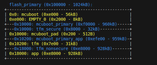

    It looks like the key difference is that I have a 'tfm' partition which ensures the TF-M application is placed in the tfm-secure region of flash.

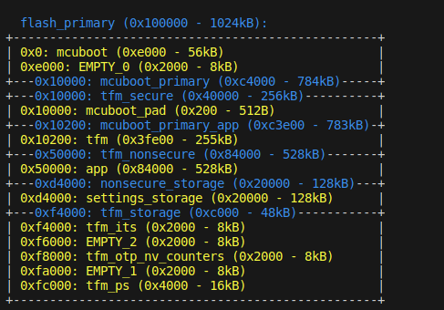

  • Sorry, I'm not sure how I missed the TFM partition while reviewing your partition file. Another thing I overlooked is that you had the nonsecure_storage area in external flash - it should only be added if you have nonsecure storage partitions in internal flash, as the SPU — System protection unit does not cover externally mapped memory. Using it for external flash will result in an erroneous SPU configuration. This probably lead to a fault exception in your TF-M app.
    secure and non-secure area in internal flash
