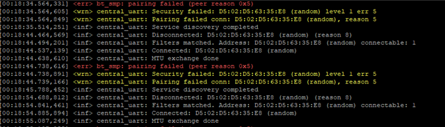

Pairing failed, security failed when using central uart example, additionally I cannot see data on the central side sent by peripheral
I am trying to established a Bluetooth communication between nrf52840dk and Fanstel BLG840F. nrf52840dk acts as peripheral device and Fanstel BLG840F acts as central device.
For peripheral device, I am using ble_peripheral -> ble_app_uart example from nRF5_SDK_17.
For central device, I am using bluetooth -> central_uart example from nRF SDK Connect.

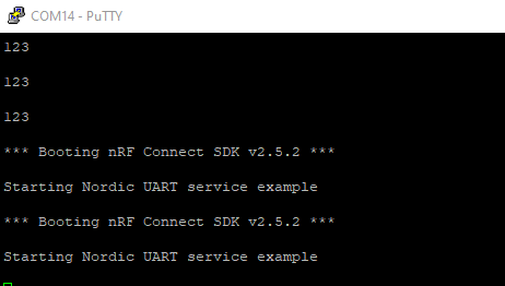

I am sending some dummy data from peripheral to central. But, I am stuck on pairing which is constantly failing if I use security. I get below error.
And if I remove the below security, the I can see the peripheral device led stops blinking. And, on central side terminal window, I can verify it getting disconnected but, I didn't receive any data on central side. I am guessing this is because ble_data_received() is not getting executed (as I have given a print statement which is not printed on the central terminal).
err = bt_conn_set_security(conn, BT_SECURITY_L1);
if (err) {
    LOG_WRN("Failed to set security: %d", err);
 	gatt_discover(conn);

		//printf("UART data sent enabled here, check pin configuration to know the data being sent correctly or not!");
		printk("%s\n",tx->data);
		LOG_INF("%s\n",tx->data);

	// err = bt_conn_set_security(conn, BT_SECURITY_L1);
	// if (err) {
	// 	LOG_WRN("Failed to set security: %d", err);
	// 	gatt_discover(conn);

static void security_changed(struct bt_conn *conn, bt_security_t level,
			     enum bt_security_err err)
	if (!err) {
		LOG_INF("Security changed: %s level %u", addr, level);
	} else {
		LOG_WRN("Security failed: %s level %u err %d", addr,
			level, err);

	bt_scan_cb_register(&scan_cb);
	err = bt_scan_filter_add(BT_SCAN_FILTER_TYPE_UUID, BT_UUID_NUS_SERVICE);
	if (err) {
		LOG_ERR("Scanning filters cannot be set (err %d)", err);
		return err;
	err = bt_scan_filter_add(BT_SCAN_FILTER_TYPE_NAME, DEVICE_NAME1);
	if (err) {
		return err;
	err = bt_scan_filter_enable(BT_SCAN_UUID_FILTER, true);
	if (err) {
		LOG_ERR("Filters cannot be turned on (err %d)", err);
		return err;
	err = bt_scan_filter_enable(BT_SCAN_NAME_FILTER, true);
	if (err) {
		return err;
	LOG_INF("Scan module initialized");
	return err;
static void auth_cancel(struct bt_conn *conn)
	LOG_INF("Pairing cancelled: %s", addr);
static void pairing_complete(struct bt_conn *conn, bool bonded)
	LOG_INF("Pairing completed: %s, bonded: %d", addr, bonded);
static void pairing_failed(struct bt_conn *conn, enum bt_security_err reason)
	LOG_WRN("Pairing failed conn: %s, reason %d", addr, reason);
static struct bt_conn_auth_cb conn_auth_callbacks = {
	.cancel = auth_cancel,
static struct bt_conn_auth_info_cb conn_auth_info_callbacks = {
	.pairing_complete = pairing_complete,
	.pairing_failed = pairing_failed
	int err;
	err = bt_conn_auth_cb_register(&conn_auth_callbacks);
	if (err) {
		LOG_ERR("Failed to register authorization callbacks.");
		return 0;
	err = bt_conn_auth_info_cb_register(&conn_auth_info_callbacks);
	if (err) {
		printk("Failed to register authorization info callbacks.\n");
		return 0;
	err = bt_enable(NULL);
	if (err) {
		LOG_ERR("Bluetooth init failed (err %d)", err);
		return 0;
	LOG_INF("Bluetooth initialized");
	if (IS_ENABLED(CONFIG_SETTINGS)) {
		settings_load();
	err = uart_init();
	if (err != 0) {
		LOG_ERR("uart_init failed (err %d)", err);
		return 0;
	err = scan_init();
	if (err != 0) {
		LOG_ERR("scan_init failed (err %d)", err);
		return 0;
	err = nus_client_init();
	if (err != 0) {
		LOG_ERR("nus_client_init failed (err %d)", err);
		return 0;
	printk("Starting Bluetooth Central UART example\n");
	printk("testing--------->\n");
	err = bt_scan_start(BT_SCAN_TYPE_SCAN_ACTIVE);
	if (err) {
		LOG_ERR("Scanning failed to start (err %d)", err);
		return 0;
	LOG_INF("Scanning successfully started");
	for (;;) {
		/* Wait indefinitely for data to be sent over Bluetooth */
		struct uart_data_t *buf = k_fifo_get(&fifo_uart_rx_data,
						     K_FOREVER);
		err = bt_nus_client_send(&nus_client, buf->data, buf->len);
		if (err) {
			LOG_WRN("Failed to send data over BLE connection"
				"(err %d)", err);
		err = k_sem_take(&nus_write_sem, NUS_WRITE_TIMEOUT);
		if (err) {
			LOG_WRN("NUS send timeout");
The code for peripheral device:
 * Copyright (c) 2014 - 2021, Nordic Semiconductor ASA
 * All rights reserved.
/** @file
 * @defgroup ble_sdk_uart_over_ble_main main.c
 * @ingroup  ble_sdk_app_nus_eval
 * @brief    UART over BLE application main file.
 * This file contains the source code for a sample application that uses the Nordic UART service.
 * This application uses the @ref srvlib_conn_params module.
#include <stdint.h>
#include <string.h>
#include "nordic_common.h"
#include "nrf.h"
#include "ble_hci.h"
#include "ble_advdata.h"
#include "ble_advertising.h"
#include "ble_conn_params.h"
#include "nrf_sdh.h"
#include "nrf_sdh_soc.h"
#include "nrf_sdh_ble.h"
#include "nrf_ble_gatt.h"
#include "nrf_ble_qwr.h"
#include "app_timer.h"
#include "ble_nus.h"
#include "app_uart.h"
#include "bsp_btn_ble.h"
#include "nrf_pwr_mgmt.h"
#if defined (UART_PRESENT)
#include "nrf_uart.h"
#if defined (UARTE_PRESENT)
#include "nrf_uarte.h"
#include "nrf_log.h"
#include "nrf_log_ctrl.h"
#define DEVICE_NAME                     "NORDIC_UART_TEST"                               /**< Name of device. Will be included in the advertising data. */
#define APP_ADV_DURATION                18000                                       /**< The advertising duration (180 seconds) in units of 10 milliseconds. */
#define MIN_CONN_INTERVAL               MSEC_TO_UNITS(20, UNIT_1_25_MS)             /**< Minimum acceptable connection interval (20 ms), Connection interval uses 1.25 ms units. */
#define MAX_CONN_INTERVAL               MSEC_TO_UNITS(75, UNIT_1_25_MS)             /**< Maximum acceptable connection interval (75 ms), Connection interval uses 1.25 ms units. */
#define TIMER_INTERVAL                  APP_TIMER_TICKS(5000) // 5 seconds
APP_TIMER_DEF(m_data_send_timer);
BLE_NUS_DEF(m_nus, NRF_SDH_BLE_TOTAL_LINK_COUNT);                                   /**< BLE NUS service instance. */
NRF_BLE_QWR_DEF(m_qwr);                                                             /**< Context for the Queued Write module.*/
BLE_ADVERTISING_DEF(m_advertising);                                                 /**< Advertising module instance. */
static uint16_t   m_ble_nus_max_data_len = BLE_GATT_ATT_MTU_DEFAULT - 3;            /**< Maximum length of data (in bytes) that can be transmitted to the peer by the Nordic UART service module. */
 * @warning This handler is an example only and does not fit a final product. You need to analyse
/**@brief Function for initializing the timer module.
//static void timers_init(void)
//    ret_code_t err_code = app_timer_init();
//    APP_ERROR_CHECK(err_code);
                                          strlen(DEVICE_NAME));
    APP_ERROR_HANDLER(nrf_error);
 * @param[in] p_evt       Nordic UART Service event.
        uint32_t err_code;
            do
                if ((err_code != NRF_SUCCESS) && (err_code != NRF_ERROR_BUSY))
                    NRF_LOG_ERROR("Failed receiving NUS message. Error 0x%x. ", err_code);
        if (p_evt->params.rx_data.p_data[p_evt->params.rx_data.length - 1] == '\r')
    uint32_t           err_code;
    ble_nus_init_t     nus_init;
    // Initialize NUS.
    uint32_t err_code;
    // Prepare wakeup buttons.
    uint32_t err_code;
    switch (ble_adv_evt)
        case BLE_ADV_EVT_FAST:
        case BLE_ADV_EVT_IDLE:
            sleep_mode_enter();
        default:
    uint32_t err_code;
        case BLE_GAP_EVT_CONNECTED:
            NRF_LOG_INFO("Connected");
            NRF_LOG_INFO("Disconnected");
            ble_gap_phys_t const phys =
                .rx_phys = BLE_GAP_PHY_AUTO,
                .tx_phys = BLE_GAP_PHY_AUTO,
        } break;
            // Pairing not supported
        case BLE_GATTC_EVT_TIMEOUT:
        case BLE_GATTS_EVT_TIMEOUT:
        default:
            // No implementation needed.
    ret_code_t err_code;
    uint32_t ram_start = 0;
    // Enable BLE stack.
void gatt_init(void)
    uint32_t err_code;
    switch (event)
        case BSP_EVENT_SLEEP:
            sleep_mode_enter();
        case BSP_EVENT_DISCONNECT:
        case BSP_EVENT_WHITELIST_OFF:
        default:
 *          'new line' '\n' (hex 0x0A) or if the string has reached the maximum data length.
    static uint8_t index = 0;
    uint32_t       err_code;
    switch (p_event->evt_type)
        case APP_UART_DATA_READY:
            index++;
                (index >= m_ble_nus_max_data_len))
                if (index > 1)
                    do
                index = 0;
        case APP_UART_FIFO_ERROR:
        default:
static void uart_init(void)
        .rx_pin_no    = RX_PIN_NUMBER,
        .tx_pin_no    = TX_PIN_NUMBER,
        .use_parity   = false,
        .baud_rate    = NRF_UART_BAUDRATE_115200
#else
        .baud_rate    = NRF_UARTE_BAUDRATE_115200
                       UART_RX_BUF_SIZE,
                       UART_TX_BUF_SIZE,
                       uart_event_handle,
                       APP_IRQ_PRIORITY_LOWEST,
                       err_code);
    ble_advertising_init_t init;
    init.advdata.flags              = BLE_GAP_ADV_FLAGS_LE_ONLY_LIMITED_DISC_MODE;
    bsp_event_t startup_event;
    uint32_t err_code = bsp_init(BSP_INIT_LEDS | BSP_INIT_BUTTONS, bsp_event_handler);
static void log_init(void)
        nrf_pwr_mgmt_run();
    uint32_t err_code = ble_advertising_start(&m_advertising, BLE_ADV_MODE_FAST);
//-------------------- user code
static void data_send_timeout_handler(void * p_context)
    // Function to be called when the timer expires
    uint8_t data_to_send[] = "Sphinx of black quartz, judge my vow. Pack my box with five dozen liquor jugs. The quick brown fox jumps over the lazy dog. How razorback-jumping frogs can level six piqued gymnasts! Mr. Jock, TV quiz PhD, bags few lynx. Waltz, testing UART services test"; // Example data
    uint16_t length = sizeof(data_to_send);
    ret_code_t err_code = ble_nus_data_send(&m_nus, data_to_send, &length, m_conn_handle);
        printf("ERROR in BLE transmission\n\r");
    printf("send sucessful\r\n");
    // Initialize timer for sending data periodically
   err_code = app_timer_create(&m_data_send_timer, APP_TIMER_MODE_REPEATED, data_send_timeout_handler);
    bool erase_bonds;
    // Initialize.
    uart_init();
    log_init();
    timers_init();
    power_management_init();
    ble_stack_init();
    gap_params_init();
    gatt_init();
    services_init();
    advertising_init();
    conn_params_init();
    // Start execution.
    printf("\r\nUART started.\r\n");
    advertising_start();
   ret_code_t err_code = app_timer_start(m_data_send_timer, TIMER_INTERVAL, NULL);
    // Enter main loop.
    for (;;)
        idle_state_handle();
