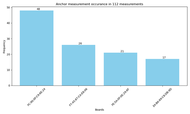

I am doing research for my paper which includes using MCPD distance measuring between nrf52840dk boards. I currently use nrf_dm sample to measure the distances. I have a problem that number of measurements vary greatly to different anchors and in different experiments, for example in one experiment in 10 minutes I have 100 measurements to one anchor and 20 to another, but when I start over again it's the opposite. As this is study for paper I need more balanced data. I tried changing config, especially CONFIG_DM_TIMESLOT_QUEUE_COUNT_SAME_PEER, CONFIG_DM_TIMESLOT_QUEUE_LENGTH, CONFIG_DM_RANGING_OFFSET_US, disabling measurements between anchors, changing adv interval, scan interval and window and few other methods but I can't get balanced data. Is there any solution for this?
Above plots show 3 experiments in the same configuration (nrf_dm sample without any changes) in 10 minutes timeframe

  • Firstly for version of app I commented fragment in main.c for anchors to work only as reflector. In mobile device for measurements I made it work only as Initiator. What's more in peer.c i added counters to count each measurement for each anchor(I had only 4) in function that prints results. I made pointers to counter values extern and later checked them in main.c where measurementss requests are added
